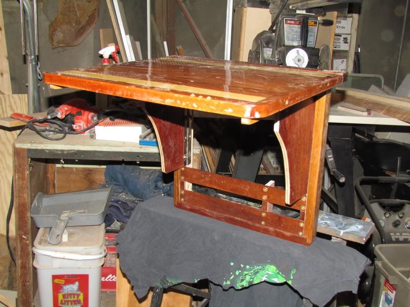

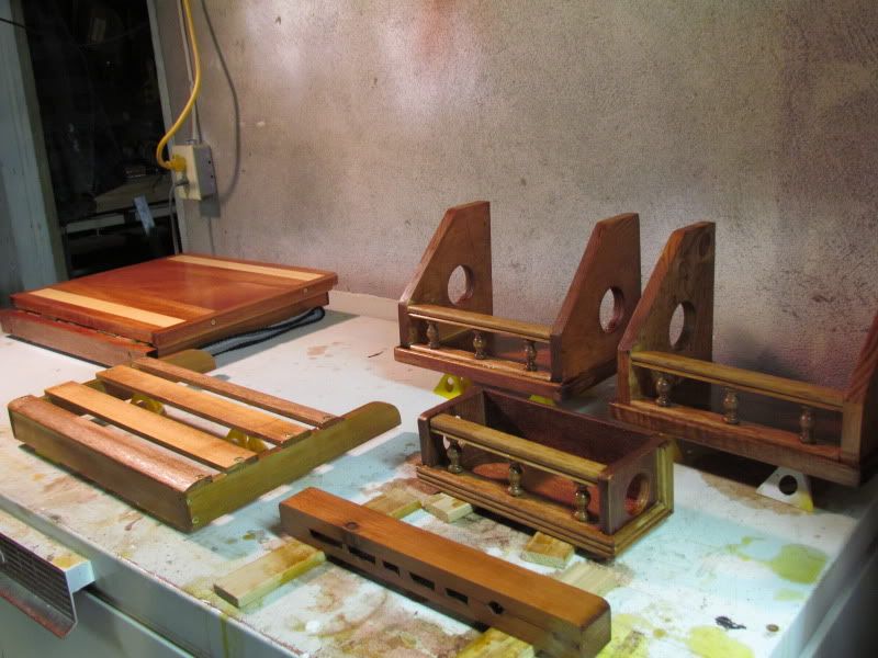

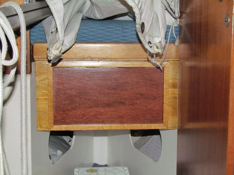

I removed a bunch of teak that had no purpose other than for looks. Cost nothing, lighter boat, less maintenance. Does that count?
My boat had a helmsman's seat that was never used. The top was decorated with teak slats screwed from below. The screws could hardly get a toehold in the thin teak and were always falling off. Last spring, I took them all off and replaced them with non-skid patches. I'm pleased; my crew was horrified.

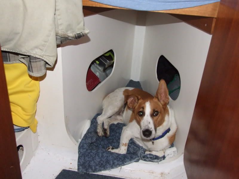

Before:

After:

Please do not tell me the dog is in that little box.

Come on, look at the expression on the dog's face- he knew what was coming.
I kept telling him, "poop deck is just a phrase! crap in the cockpit one more time, and I'm gonna keep you in a box!"
NOW he believes me.
Seriously, the dog still fits under the new box.

I've been contemplating this one for a while.
The stock cabin table for the Capri 26 drops down to make the entire cabin into a bed.
That would have been great when I was 25!
But at 61? I'd rather have an open passageway to get forward.
Anyway, two years ago I started making alternative tables for the boat.
Since I wasn't using the big bet option, I made a smaller table that didn't take up so much room.
Later I took that one down and rigged it with fold-down sides (like the stock table).
So last night, after a nice sail, we pulled the table out and brought it home for the next level.
I wanted to add the white laminate top (right now it's just West / varnish finish) and fiddle rails.
The laminate is no big deal. Cheap and easy enough.
But the fiddle rails... Aye, there's the rub.
I had bought a 4 quarter mahogany 1 x 8 about 12 feet long back when doing the shelves fiddles,
so there was plenty left from that (about half in fact). The mahogany cost $40.
But the little table is all curvy and rounded in places! Can't just saw out fiddles like they did in the
old days when good wood was plentiful.
So I'm back to laminating fiddles.
A few pics may help explain the how and why.
First is the table - upside down for the moment.
