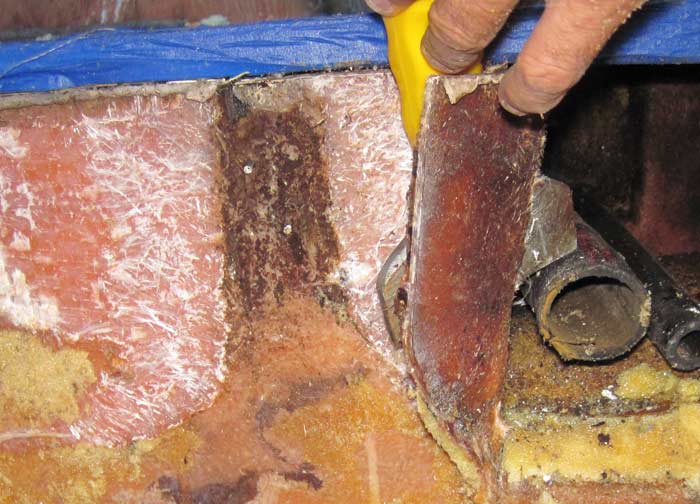

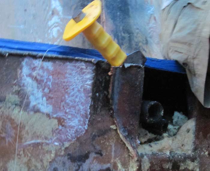

I worked a half day, and spent the afternoon working on the Pearson. I repaired the non-functional depth finder, and cleaned up a bunch of add-on wiring. I wanted to paint, but the yard office was closed, and I wanted to chat with them about their environmental requirements before slapping on the toxic paint.

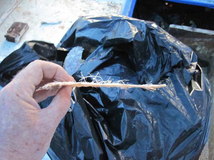

In retrospect, I wish I'd just painted because next, I attempted to tackle the shaft seal packing. I crawled into the starboard locker, and lay along the propeller shaft with my face even with the gland nut. It's 90F, and I was sweating like a ...well, never mind. Despite the cruddy look, the bronze gland nuts came apart without too much hassle. I spent the next 2 hours digging old-style, flax packing out of the nut. I used a tiny flat head screwdriver, and a pick. The old seal disintegrated, and came out in fuzzy pieces instead of a nice ring. Every time I thought I'd gotten it all, I could feel and hear the wisp of old seal rubbing on the prop shaft. Posted Image I think I've finally gotten it all now.
I've looked at the Compass Marine how-to, and I think I've got it, but I just can't tell from the remains, what size packing I should use. I have 3/16th and 1/4" gore-tex packing. I didn't have a razor knife, so I called it a day and went home to cool off and clean up.
Oh- I also attempted to improve the raw water seacock situation and failed. The bronze hull scoop through-hull and the residential ball valve are 3/8th". Worst Marine doesn't stock, nor carry in their catalog a bronze 3/8th" barbed tail pipe that I could put in place of the 90-degree elbow. Nor do they carry a 3/8th" Marelon ball valve, or even 3/8th" Marelon barbed tailpipe to eliminate the elbow.
My options are: Leave it the fuck alone, or embark on the huge pain in the ass of upgrading everything- the bronze scoop/through-hull to 1/2", install a 1/2" Marelon ball valve with the proper barbed tailpipe. This also means enlarging the hull hole to 1/2".Posted Image
Please look at the pics of the packing and help me make an educated guess as to which size I should use, and any helpful hints for getting the packing into the nut correctly.
For Tom, there are chain plate pictures.

#28 Tom Ray
  • 19,911 posts
Posted 09 August 2011 - 12:39 AM
By the way, that chainplate looks ridiculously overbuilt and if you ever manage to tear one of those out under sail, you really deserved it. ;)

Measure the shaft. Measure the ID of the stuffing box....divide by 2 and you have the proper packing. If that doesn't go well, buy a PSS.
You are trying to do too much, too fast...you remind me on me. Posted Image
#30 Cherie320
Cherie320
  • 331 posts
  • Location:...
  • Interests:...
Posted 09 August 2011 - 01:19 AM
Ajax - you have both sizes - just do a test fit by slipping the end between the gland and the shaft. Use the one that fits. Bet is the 3/16" size. Don't over tighten it and keep an eye on the drip rate until you run it a while. Should run almost drip free when you get it right.

Measure or test fit the packing.

Ajax, wish I could remember what size the packing is but i just don't. I seem to remember trying one size and not being sure, then the next size was so perfect there was no question in my mind. Gatekeeper has a good approach measuring it if you can see it. I'd go th the boat to check what is in the box but that could just as easily be the wrong stuff (I save everything,not always good).
I access that whole area around the stuffing box from the quarter berth. I take out the grate between the quarterberth and the engine and take out the bulkhead at the back of the quarterberth. Then I back into the quarterberth (hook your toes over that little bulkhead way back there) until I can dive my torso into the same position you were in from starboard,only it's a little more comfortable laying in the quarterberth on a throwable cushion. I've got this down to two screws to get out the grate and 4 screws to get out the aft bulkhead. Man, you must have been some kind of upside down doing that from the starboard locker.

I'll do my best to test-fit the packing... Cherie says it should slip through the gap between the gland nut and the shaft? I really think I would have had a bad leak with the old stuff.

Yeah, I've been tearing up boats again. See Fix It Anarchy. Today's plan: remove 400 lb engine, remove 400 lb glassed-down bench seat, cut large hole in deck, remove nasty foam, remove 10' long fuel tank, clean resulting hole. Setting up a GoPro to capture the whole thing in time lapse.
I'm expecting fiberglass roving to be annoyingly tough, as usual. ;)

If you want to get some tabbing made of fiberglass roving off, here's one fun way: a chisel and mini sledge.
Pow, pow, pow!
Pretty impressive stuff, really. (In Monty Python voice) It's wafer thin!
Yet it takes quite a beating if you really want it off!
