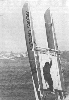

Shades of Jacob's Ladder from the late 70s/early/mid 80s.
http://www.panduj.pl.../jladder/jl.htm
http://www.cobrakite.com/jaclad.html
Posted Image Posted Image

Yup, I remember those days. The guys in Alameda had a much more controllable kite. I couldn't find their video on-line, but have a look at this one. Two things to note: one, at the end the guys just calmly walks up the beach with the kite flying from his waist, showing an amazing ability to de-power, two the waves and wind condition he's sailing in would be considered a "storm" by many on CA and this guy is just playing around. He can get airborne, but I'm sure that a "cruising boat" with all the SOTB would stay well stuck down even with a pretty big kite pulling on the bow.
Video here, and here, and here is a moderate one, finally a BIG one here.

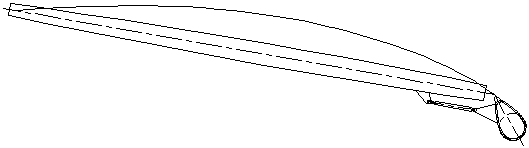

An old trick previously known as Gaf-Rings move the sail back from the mast and opens a slot that research has demonstrated increases sail efficiency - this help improve the efficiency of the sail behind the mast. Gaf-Rings slide real nice on unstayed masts - even all the way to the top! Others have used different spacer of modern materials. It works.
The Van der Stadt boom is an example of how you can move the sail curve to the lee of the mast - doing so improves sail efficiency significantly. This can be done with or w/o stays. It works.
Van de Stadt shows some seperation between the sail and the mast in the section below (might be just schematic), and shape to the back of the mast section that is probably designed to reduce the seperation bubble on the sail. The hydraulic maintains the angle between the (faired) mast and the suction side of the sail which has most of the lift. Has anyone seen any performance figures for this design ..... or is there a good reason why this wouldn't be better than current practices on larger boats with unstayed masts? Posted Image

The concept is covered by Sailing Theory and Practice by C.A. Marchaj-published by Dodd, Mead and Co - I do not have the book (yet). There is a posting here on the subject: http://www.boatdesig...sion-14714.html
I tried it on my Freedom 21 which you see in the picture I posted above. My first try was best because the sail would "fall out" in line with the backside of the mast. As I tried to rig better control lines the sail pulled more behind the mast and the benefits were reduced. This was disappointing but it is consistent with theory.
I think simplicity is essential for success so the Van der Stadt method is fine for expensive boats but overkill for affordable production boats - the benefits are real but I only think they are sufficiently important on a cat-rig or racing sloop ti build is as complicated as that.

#238 Tanton Y_M
Tanton Y_M
  • 289 posts
  • Location:Newport R.I
  • Interests:To never stop.
Posted 14 March 2012 - 02:24 PM
Aerodynamic Shape Around a Free Standing Spar and a Partial Solution. Part 2.
The behavior of wind on a circular leading edge is well known. Viscosity, pressure, and friction prevent the air particles from staying attached to the mast. Therefore the objective of this set up is to limit drake in the wake of the mast, to streamline the air flow, and to maximize sail power.
The classic jiffy reefing is the preferred method for shortening the sail. After reefing, the forward part of the soft sail leaves the "Sock" full height. The mainsail is received between the arms of the wishbone into lazyjacks which, when cruising, are left in place.
A cruising boat, such as this Cat-Ketch, can benefit in performance with a "SockSail". To what extent, is hard to say, and experimentation is in order. Maybe this half-way solution ought to be interesting to follow in practice.Attached File  793reef9.jpg   336.04K   9 downloads

#242 Doc Häagen-Dazs
Doc Häagen-Dazs
  • 193 posts
