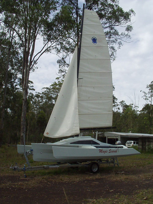

The boat I'm building is a Scarab 18, or some modification thereof.
The original design has separated bulkheads so you end up building about a dozen of various shapes and sizes rather than building more like 5 or 6 that are complete. It looks both very time consumer and much more complex and $$$. It's essentially the same size boat as the i550, and I really think I can take a lot of ideas from the i550 design to simplify.
My plan is to build the boat with 5 total bulkheads plus the stern. I'm going to make double bulkheads about 4" apart at the front and rear where the outrigger beams mount to add strength where it needs it most then put it together like the i550 without having to build a whole separate set of male forms and all that goes with it. It's just too complicated for me. I'd rather simplify and expedite it.
I was really on the fence between an i550 or the trimaran. There were a lot of tradeoffs between having to build a keel bulb or buy one, and building the additional trimaran parts. I would really like to get together with a i550 when I'm done and see how they compare in terms of sailing performance. I suspect with such similar sail plans they will be very competitive even though they are so much different in design philosophy.
