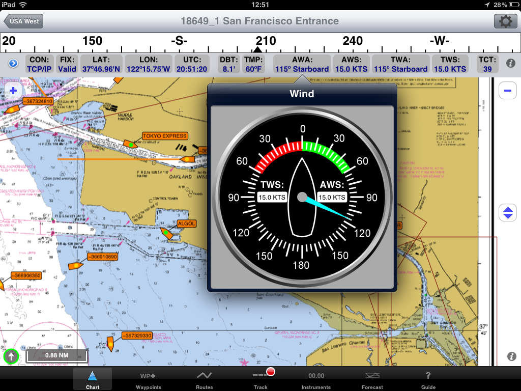

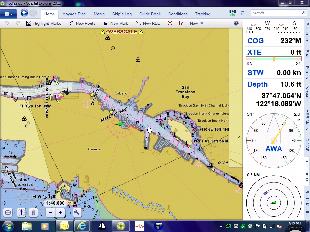

I found a review of Android apps for remotely controlling a PC here: PC World
The review is dated 5/18/2011 so there is probably more and improved PC remote control apps out there.
I've gone the iPad route using a device called a Digi Connect Wi-SP connected to my existing Brookhouse MUX. The Wi-SP is a serial to wireless converter. Every device on the boat's NMEA network can be displayed on the iPad. Running iNavX on the iPad, as well as iRegatta. Alternatively, I can plug in my laptop to the Brookhouse MUX's USB port and with the PC setup to run an adhoc network, control the PC with the iPad using an app called Splashtop on the iPad. No router needed in either case.
The iPad is mounted under the dodger using a Ram mount. To date, viewing in sunlight with the iPad under the dodger has not been an issue.
Splashtop on iPad showing Coastal Explorer running on PC:
iNavX with AIS targets and wind display:
