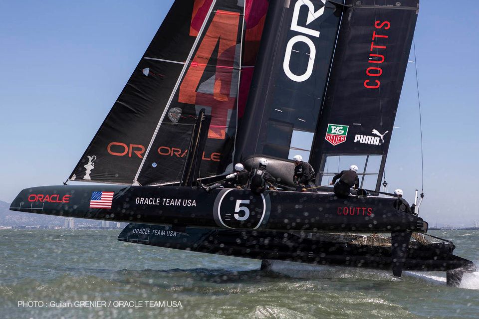

Scoop !
Want to see Oracle's AC45 sailing - flying - with foils ?
Just here :
http://www.voilesetv...usse-des-foils/
Enjoy !
HH / Voiles et Voiliers

that's high and looks nicely in control
some serious forces on at the bend of the 1 L foil holding everything up

Nice, the bottom of the L looks like 1 Spitfire wing. The engineering at the intersection of the L must be something special. I wonder how they are controlling the pitch angle on the board, as it doesn't look like they are adjusting it on this one - just the standard AC 45 setup. Fascinating - don't see the t foil rudder pitch control either, but it is a far away shot. Nice scoop.

That boat has that funky pod thingy in the wing, too.

Is that for real?
Any way that it could have been photoshopped?
Any confirmation from inside sources about this experiment?
I don't know anything about hydrodynamics, except for one thought about Froude numbers and the difficulties of reasoning from tank testing to full-size boats. For those who do know about foils, does this "look right"? Could such small foils really lift an AC45 like that?
The AC72 class rule prohibits adjustable foil surfaces while sailing, except for a weed knife.

no need to photo shop that, it's been done before. i won't say it's easy, but it ain't rocket science.
Good job though for OR, looks fly

Iconic AC34 shot. Geeezus, will they try that on an AC72??

A video would confirm it but I suspect that the shot was taken as the AC45 launched off a wave. I don't believe it is 'foiling'.
We have seen pictures the 'L' foil and 'T' rudder on the AC45 back in Feb so nothing new here.
We have also seen pictures of TNZ testing SL33's with 'L' foils and 'T' rudders.

Not likely PhotoShop. Truly outstanding piece of work if it is. And of course earlier pix show the L-foil. Anyway a video sequence will provide convincing evidence, hence my earlier comment.
As an interested sailor I've followed sailing foil developments fairly closely over a couple of decades but I claim no technical knowledge of performance. Lifting with a small foil like that is not the problem if you have sufficient power to weight ratio. The problem as others have noted is control.
It is intriguing that one really good photo should suddenly pop up, virtually out of the blue, and from a French source at that.

I suspect all -- well, perhaps not all -- will be revealed in Newport, RI on Monday afternoon, 25th June. Oracle is holding one of its group interviews for invited media. Agenda includes Newport plus news from the training and testing session that just finished in San Francisco.
JS, JK and Dirk Kramers will be on the stage. It kicks off at 1100 hours local time.
I'll hazard a guess that the photo was a clever PR plant to drum up interest. No outside photographer would get that close to the boat while it was actively testing.
Perhaps we'll also learn about the pod in the wing!

Pod = Gyro system for the foils?
But why would they give away some secrets this early? Something to goose-up the 45's?

Holy Hell, that would be an entirely new thing to think about. How many grinders committed to full-time spinning a gyro to keep boat flat? IF that is going on. Pretty big "IF", but we are really sailing uncharted waters, here.

Well, I did not see the little wand like the Moths, etc, use to adjust the angle so I thought gyro. But maybe too far out there?

I'm a little suspicious-the lee daggerboard looks too far above deck, for one thing, and for another where is the altitude control system(wand), or is it manual or electronic? One things for sure there has to be one because those are fully submerged foils......

When you say gyro do you mean a small one for measuring the inclination or a masssive one to actually keep the boat level?

I believe he was thinking the latter. That Pod thingy has been a mystery, and you certainly would not need something of that size for the former. I think the very idea of a gyro in this context is WAY out there, but I'm certainly not going to say it is impossible. Something would have to keep that boat flat, and in the absence of some form of elevator on the rudder, which is not allowed, this could be an option. Would a gyro effect be strong enough for this type of situation, and would it also make turning the boat a bitch? I am not seeing the point of having it incorporated into the wing, though, but it would not be first time that I could not get the point at first.

Hard to see what if any swell they jumped out of; that one in the foreground ~may~ have had the right slope at their speed

This is obviously an intended release from Oracle. All the photos are from their official photographer.
To my eye, there is no evidence that the boat was captured as it launched off of a wave:
1.- There is no wave in the photo
2.- There is no splash or spray coming off of the hulls as one would expect if they had just been flung off the top of a wave.
3.- The roostertail coming off the starboard foil is long and uniform in shape and looks as if the boat had been travelling in that attitude for some time.
4. The crew do not look as if the boat had suddenly been thrown four or five feet into the air. They look as if they are relatively comfortable and in control, not hanging on for dear life.

I really hope this is what their 72 looks like! Although now if one aims at one day competing in the cup, do they train in moths or cats?
We won't see this on an AC72. But it seems to me if you can make it work on an AC45 you would have a boat you could train on at the speeds of (or at least close to ) the AC72's. Good plan in my book.

Is that for real?
A video would confirm it but I suspect that the shot was taken as the AC45 launched off a wave. I don't want to believe it is 'foiling'.
Corrected.
Maybe GD has a few similar shots of TNZ then.

Posted 25 June 2012 - 05:35 AM
Wonderful pictures, amazing.
It seems that the foil is very well placed as the boat seems very well balanced.
IMO, the foil is a bit too down and the boat a bit too high considered the state of the sea. The higher the boat the less power, however we don't have the full sequence.
It could be using a sonar to determine how high out of water they are, I have tinkered a little with one on my Moth and it could be quite effective if battery life and class rules weren't an issue

the dagger length fishiness doug commented on in the earlier shot
is even more apparent in this pic...
do we know how they lock the dagger down enough to support the boats weight like that?
I agree on both. If Mirabaud can foil I don't see why an AC45 could not. What we may be seeing here is some development of technology that - unlike wings - will feed back into general high performance sailing. That would be interesting.
For those who have never been near a foiling Moth, what's spooky is not only that they are going so fast but that it is almost silent. You don't see them coming because they sail completely different angles but you don't hear them coming either. Fortunately they recognise they've just got to avoid the rest of us!

That's some serious sailing! I am having a hard enough time believing that L foil can hold up the AC45, much less that they have a gyro that keeps the thing going level. Whatever they are doing, I can't wait to see it in action on the AC72. I am skeptical that it will end up on a boat that the rest of us can purchase and sail.

You can purchase a foiling Moth off the shelf today so I don't see what's so hard to believe about trickle-down of technology. Whether you could sail one I couldn't say. I know some Mothists and persistence and fitness are certainly requirements.
If Mirabaud can foil in not very much wind I'm not sure why you believe an AC45 could not do so in SF conditions.
Of course the terrible thing about this development is that Doug Lord will be hitting SAAC.

Buuuuttt... Mirabaud doesn't have L-boards, much less a giro.
They where testing the boards on the AHPC C2-F18 (Bundock is their European distributor).
Although a bit impractical for launching of the beach it is certainly not impossible.

That is a VIPER not a C2. I believe they were testing the L-foils as an answer to the curved foils of the Nacra17. I don't think the intention was to ever 'foil' just to provide lift
We may not see these exact foils on the AC72 but you can rest assured that there will be some very similar foils out there.. These, among others, are the type of things that will win the cup for whoever has the clackers to think outside the square..

i don't think the bubble can be a gyro to stabilize the boat
for that the gyro would have to be very heavy and mounted on the boat not the wing
are there side views?
could it be camouflaging hydraulic rams?

There are more photos on Sail World. Impossible to tell from the photos whether foiling is sustainable, but the amount of leeward heel is not good. The leeward foil loads up hugely in this attitude, you never see a Moth foiling to windward with leeward heel. They capsize.
Some leeward heel is manageable downwind, but only because the apparent is very much less and it can be controlled. Moths usually sail very flat downwind because that's fastest, with maybe a little leeward heel as it means going deeper (but slower).
I would think the ideal attitude would be with the windward hull just touching the water and the leeward hull well clear. Far less load on the foil and much easier to balance, but tough to manage in such a large boat. The mainsheet trimmer will be working overtime and in perfect harmony with the helm.
As for pitch control, it can be best done using rake on the rudder, only small angular changes are required. Altitude adjustment is a puzzle, maybe it's manual. One method is to bleed air onto the lifting surface to reuduce lift. Dunno how efficient that is though. Maybe there's a rake control on the c/b to change the angle of attack and hence lift. It would be a very fine line to get it right though, a flap is much more controllable.
rake on a rudder with a fixed T foil
is going to be problematic...
the standard ac45 rudders come up from the bottom don't they?
any rake system back there would probably be too extensive to allow the boat to stay in the acws

Crash pads for when the foils stop lifting and they go a-over!
I actually think they might be look-ahead sonar/wind instruments - totally unrelated to the foiling and more to do with predicting the wind up the course.

Not the hulls they are using in the acws, they have 4 of them, but the surrogacy rules 'should' be taking care of these sort of mods I believe.

again you'd be better on the main beam due to wing rotation
but maybe the wing if they want to keep the boat in the acws...

The round Gennaker does not match with the supposed speed in my eyes. Should have collapsed. Something is fishy also with the length (different?) of the daggerboards. uuhps, corrected: It is the pole which is being used for raising and lowering which distracted my eyes.

Don't mix the dagger boards up with the lifting post in front of them.

good point, there is a lump halfway down the pole that must be the top of the board

I wondered about it being photoshopped but I no longer think thats the case after seeing the series of photos on Sail-World. But one things for sure: these are fully submerged foils-not surface piercing foils(that automatically adjust their altitude)-they MUST have some form of altitude control by all that is holy. If you took a Rave or an Osprey and ripped off the wands I can gurantee you that the boat wouldn't fly for long. However, the Rave was flown by two different guys using a manual system.
Another thing to consider is that every cat that has been flown 100% so far has been slower than its hull born sisters-the most recent being the C Class "Rocker". Yet, it has been proven over and over that cats with "foil assist" that only partially lift the boat are faster than the non foil assist boats. Somebody earlier said : "lets see the video" that would probably tell a lot....
Still, its so cool to see this boat flying-just fantastic!

from a control perspective, my thought is that the rudders are the biggest concern. I estimate that there is only half the rudder (<1/4 area) left in the water in the shot which leaves it vulnerable to leaving the water entirely.
Pitch or yaw control with the tiny horiz stabilizer/rudder areas isnt going to be very effective at that point.
If you loose your rudder, what is the possible aoa range of the main foil assuming it is fixed relative to the hull. If you go past the zero lift aoa it's going to start pulling the boat in, catastrophic turtling inevitable.
Either that, or the balance needs to be wayyyy out. Which cannot be optimal, and is not reflected by more balanced stabilizer areas between the dagger and rudder.
I think this might be dis-information.
And would this get past the adjustable foil rule? if so, helm can handle that with a "twist grip" on the tiller extension ala the Bieker I-14 gantry foils.
8.3 Rudders shall rotate only, and that rotation shall be about a single axis which is within 10
degrees of vertical. This rule does not prohibit the use of self-aligning rudder bearings.
8.6 Rudders shall not have components such as trim tabs or moveable winglets, that can be
adjusted while racing. However, a movable or retractable device whose sole purpose is the
removal of weed or debris is permitted.

anybody found a pic with a view of the tiller / tiller extension? That would answer a bunch of questions being raised here..

There is this one, go to here then "Click here to view large photo." Still, hard to tell what's going on back there.

I think they are just having fun with the rest of us. With only one lifting foil in the water, stability has got to be a momentary thing. They've been testing L-boards, and these pictures were taken on a particularly windy day during an exciting and photogenic moment. It's very cool to think about, though.
(In the picture above, I don't see a t-foil on the port rudder. Am I missing it somehow?) NEVER MIND. Looking at the larger version, I see it.

The final inverted T of the rudder can be viewed very well in the original photo of Voiles et Voilers
When I was testing Greg Ketterman's bi plane foiler in the 1990s the foils were no "adjustable" but rather auto correcting. By far the best days of sailing ever. Sailing on foil is magical and the G forces in the gybe are amazing. It is super quiet and surreal acceleration. I can't imagine what the momentary loads look like on a 45 let alone a 72 but I'll tune in to watch it that's for sure...

That looks like it's just a moment of glory. Design the lifting foil so it only lifts the whole boat when you are absolutely screaming, like in the photo on a broad reach. Perhaps they can adjust angle of incidence somehow but not actively I'd guess.
Though the rule was intended to prohibit active foil controls, AFAIK it only prohibits flaps and long daggerboard trunks. There are ways around that limitation but they are pretty clever. I would be surprised if no one is trying them out, but I don't see it happening in this series of photos.
IIRC the tradeoff occurs at 18 knots. Above that speed, you're better off out of the water on a 72' hull. Since these boats will go that fast and more upwind, they would theoretically be better off on foils all the way around the course. But this system seems like it is only designed to assist, and in the photo they are just showing off a bit.

Some closeup of the rudderfoil.
Great shot as well:

The lee daggerboard is only half extended, which means the horizontal portion is at or very near the surface - not a steady state condition, unless it's designed to work as a surface piercing foil

But: once they are out, the lateral resistance force needed and provided by the standard daggerboard haye surely droped, It could be a good thing for vmg downwind, but surely not upwind! If my premises are correct, why did they not place the horizontal part of the L higner on the board to keep more vertical surface in the water and therefore more lateral resistance? And the same thinking can be made on the rudder... once they are up, they keep just a few square centimeters of the rudder effective, which could be very dangerous for controling the boat at those speed...
Foil a little bit upper on the board, like inverted f, in the spirit of this incredible new boat
