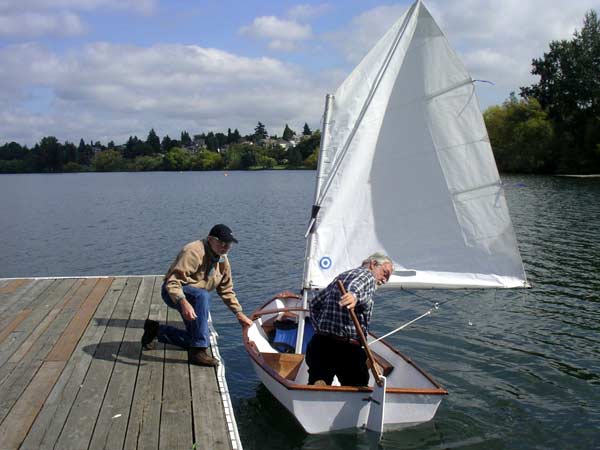

On a small boat, there is no halyard, but on a big boat, there might be.
Again, on a small boat, there is no peak halyard. The peak is held by tension in the head of the sail, similar to the way a wishbone boom is held by the foot. The hell of the sprit is held by the snotter. On big big boats (e.g. those 100 ft English barges) there are all sorts of extra lines, e.g. lifts on the middle of the sprit to keep it from sagging.
Gravity suffices to lower the sprit.
The picture shows a braille.
