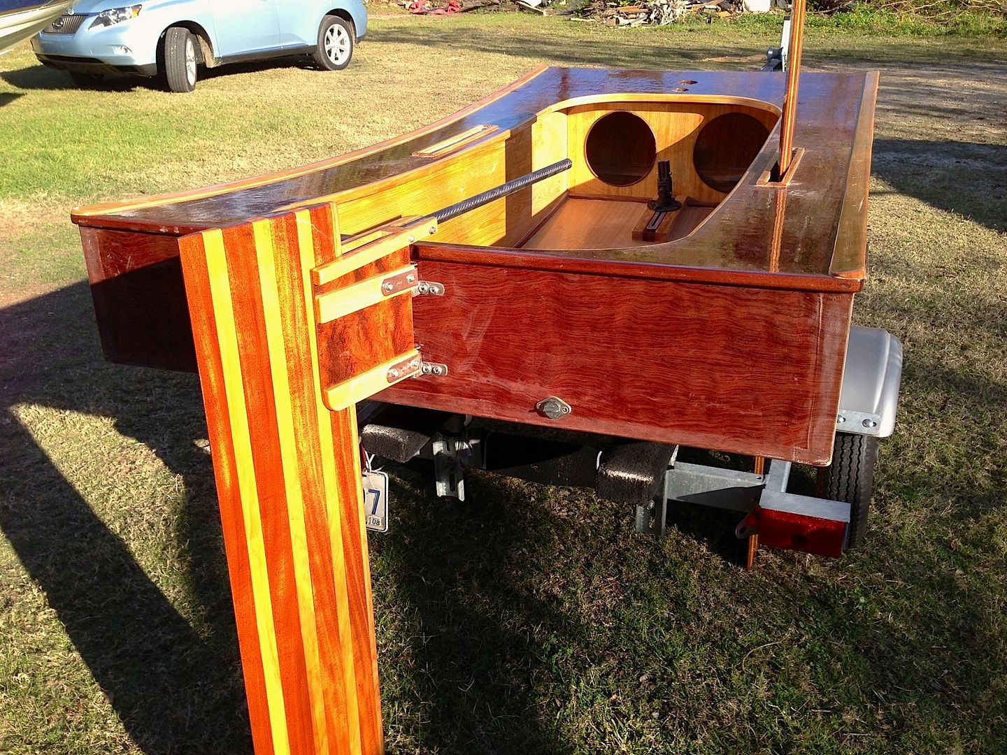

Hee hee, speaking of expensive boats to have built, check out this furniture grade Puddle Duck Racer.
It's going to get a blue hull. The owner did not want it to live outside and puzzled over how to get his wife to allow it indoors. The solution: exotic and beautiful woods and a glass top. It's going to be a coffee table when not in use! Possibly not the best use of vanishing hardwoods, but excellent wife management. ;)
I thought that was called "husbanding your resources". Or "Keep your friends close, keep your enemies closer".
Cool
And I bet you can stack a lot of magazines on the trailer, too.

I wonder how much that would weigh if built with that heat-shrink Dacron skin?
Well, the design weight is stated to be 200 lbs which IMHO is a bit optimistic for a ply 16-footer. If you could build one of these to weigh 200 then you could build my design above to be 140 or so, it's really that much less materiel at baseline. Another issue is the self-bailing, a traditional boat like the Walkabout will be carrying at least a couple of gallons of water around any time there is enough wind to fully power up.
It's a beautiful boat and sure to be (like all his designs) at the high end of performance for traditional types. I was thinking about stretching it just enough to add a little cuddy without spoiling the looks and a higher self-bailing sole... have to figure out where to take some weight out of it though.
"To improve any boat...simplicate and add lightness" -Uffa Fox
I believe that one of the notions for for JW and Chuck L. to participate in the EC in a stretched version. I think Chuck built the boat.
I don't know if you've ever seen any of the Monfort boats in the flesh, but along with the very light Dacron skin, all the wood structure is also very light. It's easy to imagine a loaded boat (included loaded with water) suffering severe structural damage. Also, sailboats don't necessarily benefit from very light weight without some compensating factor like being a multihull, or having a super-athletic crew.
But I have pondered some ideas along the same line i.e. a big canoe fitted out to sail as well as possible. I'm thinking something along the lines of the Grumman aluminum canoes of yore, though maybe a little beamier if starting from scratch. There is no reason why it couldn't have a fabric skin. The sailor would have to work harder than in a boat like Walkabout, probably sitting on a seat out over the windward rail. For me, being out in the sun and wind would be very bad news unless I was set up with intravenous Gatorade, but that's just because I'm old and frail. Or at least, not young and hardy.
Stretching a design is a good option IMHO. It doesn't increase the weight proportionally, but the cubic, the speed, the stability, all increase above linear proportion.
For example, another great Welsfor design is the 17 1/2' Pathfinder (clicky linky) which is very similar in form to the 16' Walkabout but it weighs more than twice as much... here's one with a with cuddy cabin (clicky linky)... I bet if you just spaced the frames for a Walkabout 10% further apart, you'd get a boat that was much bigger & faster but only about 150% as heavy.
Still doesn't solve the sleeping-in-a-puddle problem. I amy be overly agonizing about this, but I spend too long a period of my life cruising in boats that leaked. Putting all your gear in a watertight bag, bringing along another bag just for towels, and bringing along an extra ration of fresh water to sponge the salt off everything, all adds nothing to the enjoyment and quite a lot to the baggage encumbrance (especially on a <20-footer). Maybe those who are less spoiled and effete can just shrug it off and spend a few nights sleeping in a wet salty bed. Having a front row seat in the wilderness makes up for a LOT !!
A Welsford boat that addresses this very problem... and also starts from my favorite and most familiar jumping-off point, the racing one-design dinghy classes... is AWOL (another clicky click link) with a big watertight raised deck inside. Not as traditional-looking though, and I don't know if there is provision for effective rowing.
Never saw one. I also found the 200 lb figure to be a bit optimistic and was thinking (still) of avoiding owning another trailer. You guys are on a roll and very distracting. I need to get back to work if I am ever to be able to afford this kind of fun. It's for rich white guys, I hear. ;)
