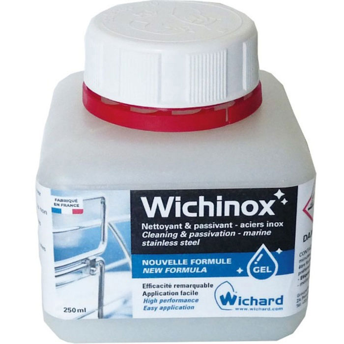

Passivation is a process by which steel becomes "stainless" by immersion in a heated bath of phosphates.
In a salt water environment this protective film is often worn or corroded away.
Wichinox is a non-hazardous paste which contains a phosphoric acid that will re-passivate, seal and protect your stainless steel.
As I understand it, the grade of (high-strength) metal preferred for shackles these days is more susceptible to surface corrosion than other grades of stainless; long-term shininess has as much to do with how well the piece is finished as how well it is forged, or in what material. Tylaska is famously obsessive about finish, Wichard not so much. So follow-up polish and passivation should take care of things, assuming standards aren't slipping in other departments.
