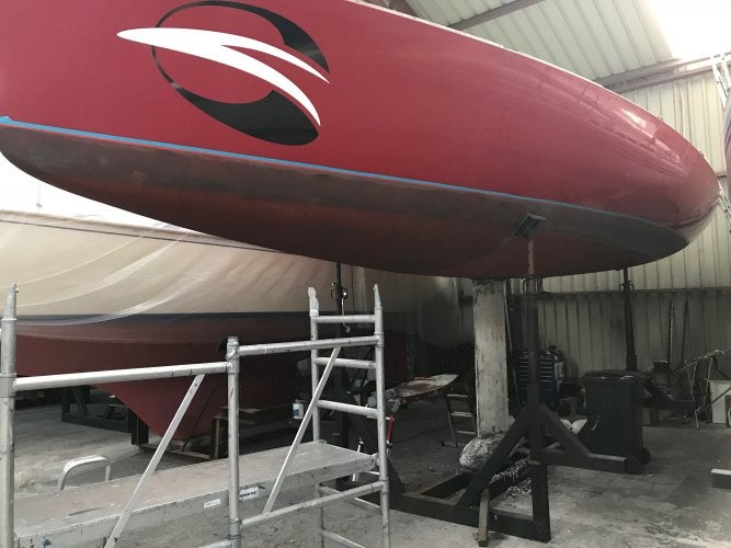

IanA. 482 Posted August 17, 2020 Author Share Posted August 17, 2020 Got around to the underside this weekend. Did a big fair up on saturday of the keel and rudder and then got a nice heavy coat of high-build primer on. Used Alexseal superbuild 302. Was the first time for me and was impressed. It mixed and went on much smoother than Awlgrip ultra-build which I am more used to. The next day I was able to convince some of the team to join in on some overhead bottom fairing. Was a hell of a job but we made better progress than expected. We used a variety of tools and learned a few techniques along the way. Our neighbor loaned us his Mirka Deros electric DA which gave me serious tool envy. We also had the old school Rupes powered longboard going which was pretty effective but weighs a shit ton and could only be used in short runs. We got just a bit past halfway which is a huge step forward for the program. Just need to finish up the back end and then can get solid coat of highbuild on and do the final fairing. 1 Quote Link to post Share on other sites
IanA. 482 Posted August 17, 2020 Author Share Posted August 17, 2020 A few more shots of the labour and progress 1 Quote Link to post Share on other sites
