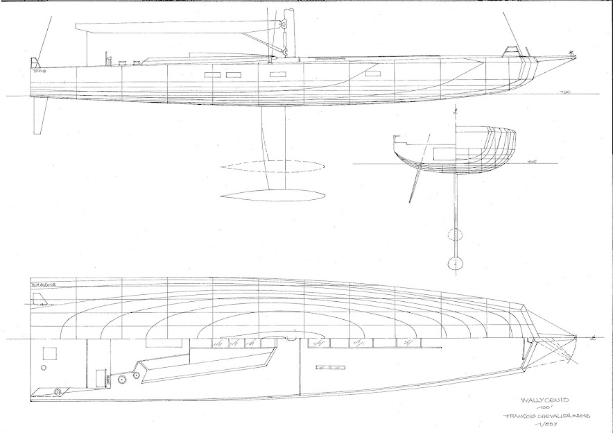

Figure 2: WallyCento, lines, sections, profile and half-deck
Figure 4: WallyCento, interior layout
The reason to design yet another Wally lies in the designation of the WallyCento rule itself: owners remain keen on the combination of comfort, performance, modern design and bleeding edge technology in a yacht. Even if the WallyCento open box rule forbids canting keels and includes a minimum displacement figure, she remains true to the Wally essence which has begot its prestigious fleet: simple handling, automated sailing systems, utterly flush decks, light and minimalist interior spaces.

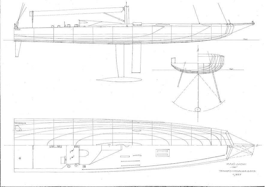

Figure 5: MaxiScow, lines, sections, profile and half-deck
The "Record" designation of the MaxiScow version, which features a more lightweight displacement and a canting keel, rid of all the modcons and automation usually presented in Wallys, targets ocean records and line honours in crewed races such as the Newport-Bermuda, the Fastnet or the Sydney-Hobart.
As featured in the wetted surface diagrams comparing the MScow concept with conventional monohulls when heeling, the key advantage of the MScow is her underbody, which under a heel sails at an angle which would be three times smaller than a conventional yacht. On the one hand, the righting moment is a lot more efficient, whether or not she is fitted with a canting keel, and on the other hand, the keel remains in the centerline under sail: The result is the MSow's better ability in pointing to windward, by one or two degrees depending on configuration.
To improve the sailing platform's performance, the bowsprit can be orientated and the clew of headsails can be adjusted in the lateral plane.
Figure 8: WallyCento and Maxi Scow compared with conventional 100-footer
On a level plane, the lines of the WallyCento and MaxiScow are reminiscent of a windsurfing board.
On a heel, the angle of the wetted line with the centerline is a third of that of a conventional racing 100-footer.
As far back as the 1970s, I made a concept for a crossoceanic windsurf designated for a double-handed Transatlantic race. As for many projects of this kind, the model is still hanging on my office wall. The idea remerged ten years ago when I wrote an article investigating the origins of planing hulls. The craze which governed the American skimming dishes at the turn of the twentieth century, with waterline length as the only limitation, had given me the idea to develop an IMOCA Open 60 for the Vendée Globe single-handed circumnavigation race.
I decided to develop a progressive chine-bilged scow, and instead of a pram bow, I proceeded to cut away the stem very significantly to avoid wave slamming as much as possible. By tapering the bow both in height and in width, shocks with head waves are dampened significantly and the scow skims the surface immediately and displaces as little water as possible.

Obviously a large scow is not an allround yacht, and certainly not perfect in "any sea state", but then again no boat is. The proposal is taking the scow paradigm and giving her all the elements permitted and suited to inshore Wally racing and offshore records. Tapering the pram bow is just a subelement giving her a slightly more versatile edge.
For those familiar with the Wally regattas, short inshore courses set in spinnaker sailing Mediterranean summer conditions, the WallyCento Scow is perfectly suited. For weather windows creating seastates suitable for testing the capabilities of the Scow offshore, she can certainly demonstrate her ability to gobble miles off the wind, and the faster she does it (the idea after all is to break records) the sooner will she avoid adverse conditions and head seas. The idea is a windsurf, not a wave slammer, but the size and the tapered bow goes a long way to make this a yacht which is conditionable to the ocean - with a definite edge for offwind.
