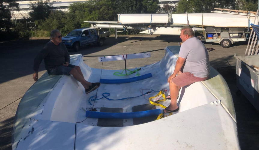

Chewing the fat in the boat with Winglets on, not quite good enough I know Stanno.

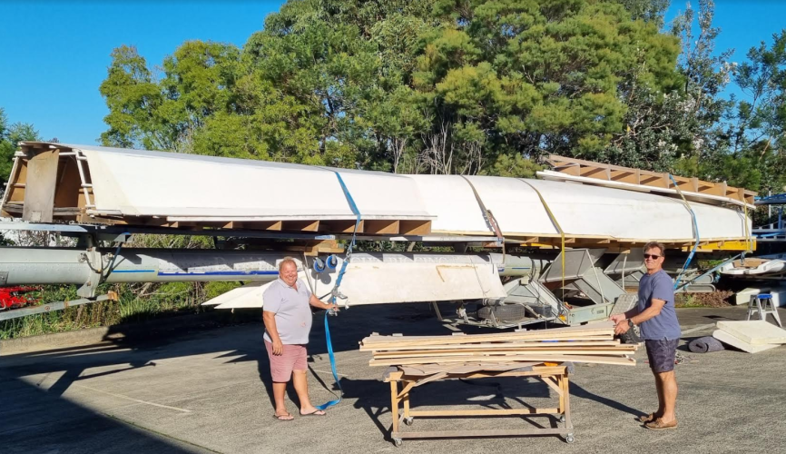

Plugs are loaded onto the trailer in the back ground.
A better shot of the catastrope.    As I type this they are north of Newcastle, and should be in Brisbane by late afternoon/
