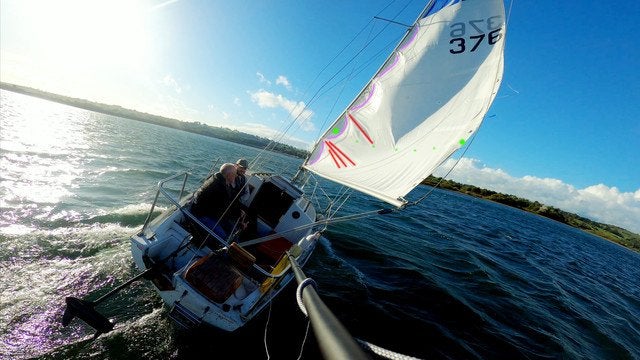

You should raise the mainsail tighter on the hoist. You do not want those scallops along the leading edge as outlined in pink. When the sail is hoisted tight enough, the scallops will disappear along with the wrinkles radiating from the slides (wrinkles shown in red).

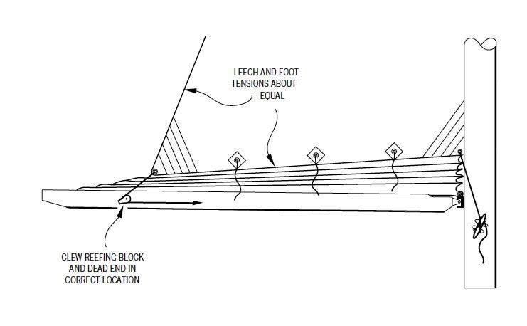

You should not let the sail cloth flutter -- it will drastically shorten the life of the sail. If it's too windy to pull the sail in enough to stop the fluttering, you need to "shorten sail", also called "reef" The reef points are in green, The larger grommets (also called cringles) at the front edge of the sail (the "luff") and rear edge of the sail (the "leech") are what matters. The smaller grommets between the two main grommets are merely for tidying up the loose cloth. The drawing below shows how to reef. You might need to install additional hardware on the boom and mast.

Thanks for your drawing and explanation.  I didn't even notice the wrinkles.  Looks like there's still a lot to improve at.
