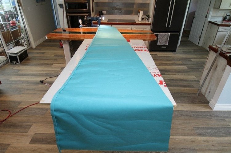

After cutting the Sunbrella with a hot knife, I folded in the 1" webbing into the bottom where the grommets will go - 3 layers of canvas + webbing should hold well
I used 3/8" basting tape to keep things in place

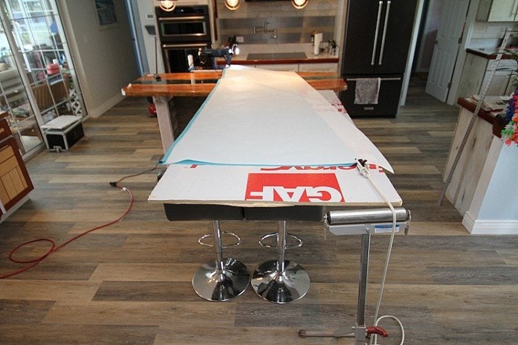

To sew it, I had to modify the "sewing table".  Bottom row was sewn first
Then I took the sailcloth liner and tucked it under the fold and sewed that in.  I used a clamp as a weight to help things along.

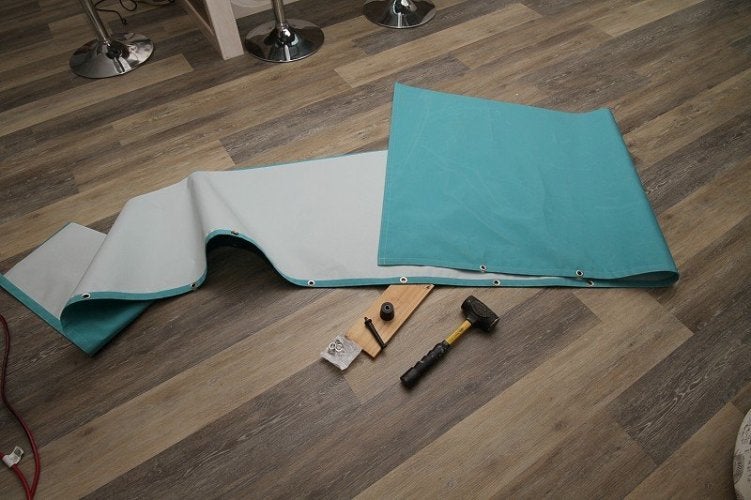

Today I installed the SS grommets, leaving the last two out.  I need to measure the extents of the main outhaul slider.  I really had to beat the crap out of the grommets to get them to sit flush.
