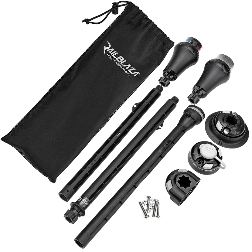

I’m thinking of making a running light that uses the mast-step like that. Are those windsurf masts?
These are kind of expensive but do the job:
Breaks down and stores under the seat when not needed. Maybe the same sort of thing could be rigged to a mast step. Maybe a boat-hook type pole? Seems like more of these mounting system gadgets are getting a little bit standardized.

I already have a mast step. Much easier to buy the light and if cheep, get a pvc pipe or a used mast base.
:unsure: If I were clever, I’d use the existing rig and some Velcro, but that’s a big if.
