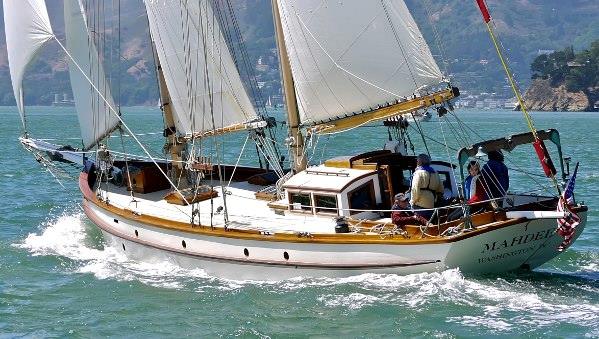

Gone from “Chlorox bottles“ [Sonsr, Viper 640, Melges 24] to a pseudo-classic. But they get a lot of compliments for looks/coolness. Previous owner. PHRF rating of one million.
