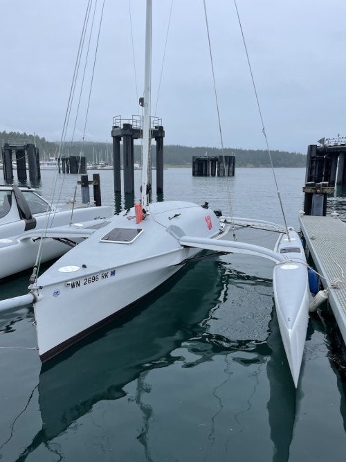

I kind of missed this thread but figured I'd share the modifications I've made to Makika (f25-c).   I've un-farriered the cockpit and removed the annoying "lid" over the huge hole that was there.  I found both to be unnecessary design choices where compromises were made.
Just finished the cockpit remodel for a race this last weekend and it is SO much nicer to race this way, feels like a sports boat.   you can stand side by side in the cockpit trimming etc with plenty of space and you can quickly pass float to float when tacking/gybing etc.     The removal of the diagonal combing means that you have a flat spot, further outboard to help from if you are helming in the cockpit which is actually passable now (typically we helm from the float).   I also removed the annoying, loose "lid" over the cabin top and its a lot sleeker now.
That is a sleek looking boat.  Very nice.  Did you build her?  Do you need the 3 to race?

I love that you removed the diagonal coamings. Those are stupid. Removal would make the cockpit of the F-27 so much better. The pop top not so much, I love that. Its really nice to have standing headroom at the galley. I realize yours is a pure race boat though.

Yeah the combings drove me nuts.     I would not remove the pop top either if I had a galley or a reason to spend more than 5 mins wanting to stand up inside.   I do cruise with my kids every now and again but its a "take a jet boil and think about the boat as a hard shell tent" kind of cruise.
