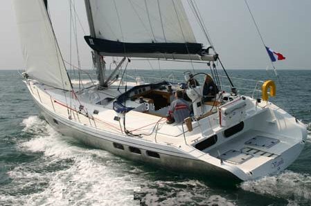

Here you go. Powered winch on cockpit floor. No track.

From the pics, shouldn’t that boom clear anyones head by a good amount, almost regardless of where they are standing, and if the wife was struck by the boom, she would be on the deck or overboard, how would the husband be hit by the boom helping her? Wouldn’t there be damage to that dodger and/or the lifelines if it dropped that low due to loss of sheeting and boomvang?

Failed boom vang. There is no topping lift on that rig.
Does look like that, was just wondering how the dodger wouldn’t stop the boom on one side or the other. My questions aren’t meant to be leading or anything, never sailed on a boat like that, just genuinely curious how that could happen and how to avoid something seriously sad on a much smaller boat.
