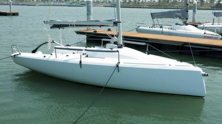

Hi,
Does anyone have any info on the Fareast 19 R in terms of performance, build quality, etc.?
Other than the J/70, what other sport boats exist that:
  • Perform well
  • Can be ramp launched (retractable keel)
  • Are less than 40K
  • Range from 18 - 24'
Thanks!

Well the i550 fits the bill except for too sporty, wet, athletic, too. BUT, There are a couple for sale at 15 to 25% of your budget. Just by the appearance the the Fairest 19R looks too wet, sporty athletic , too.  Try to find an Ultimate 20. I think there was one in the Colorado craigslist recently. Also an Open 5.70 in th Colorado Westslope Craigslist. 40862260_1827917257246187_1150417126356418560_o.jpg 1276510_10151813869657789_3368903_o.jpg 30704682_10155562893776647_509106008775984745_n.jpg

Sailed the Fareast 23r. Nice boat, but a lot of wetted surface to overcome when the wind lightens. For a 19 footer, VXone would be my choice.
