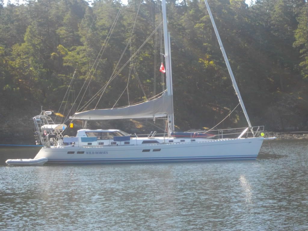

Wild Horses also looks lovely.
Bob - since you've worked with a lot of production manufacturers, and many of your designs are cruised, why do the manufacturers not call for a hard dodger in the original design?
31,953
1,364
Morning:
I think they would today. Years ago you were lucky to have a canvas dodger. I think today we are softer. Maybe smarter. I don't know. I've never owned a boat with a dodger hard or soft. I suspect that any US production builder (are there any?) would spec a hard dodger today on anything over 34'.
Thanks for the kind words on WH. It's not so hard when you have 63' to work with.
