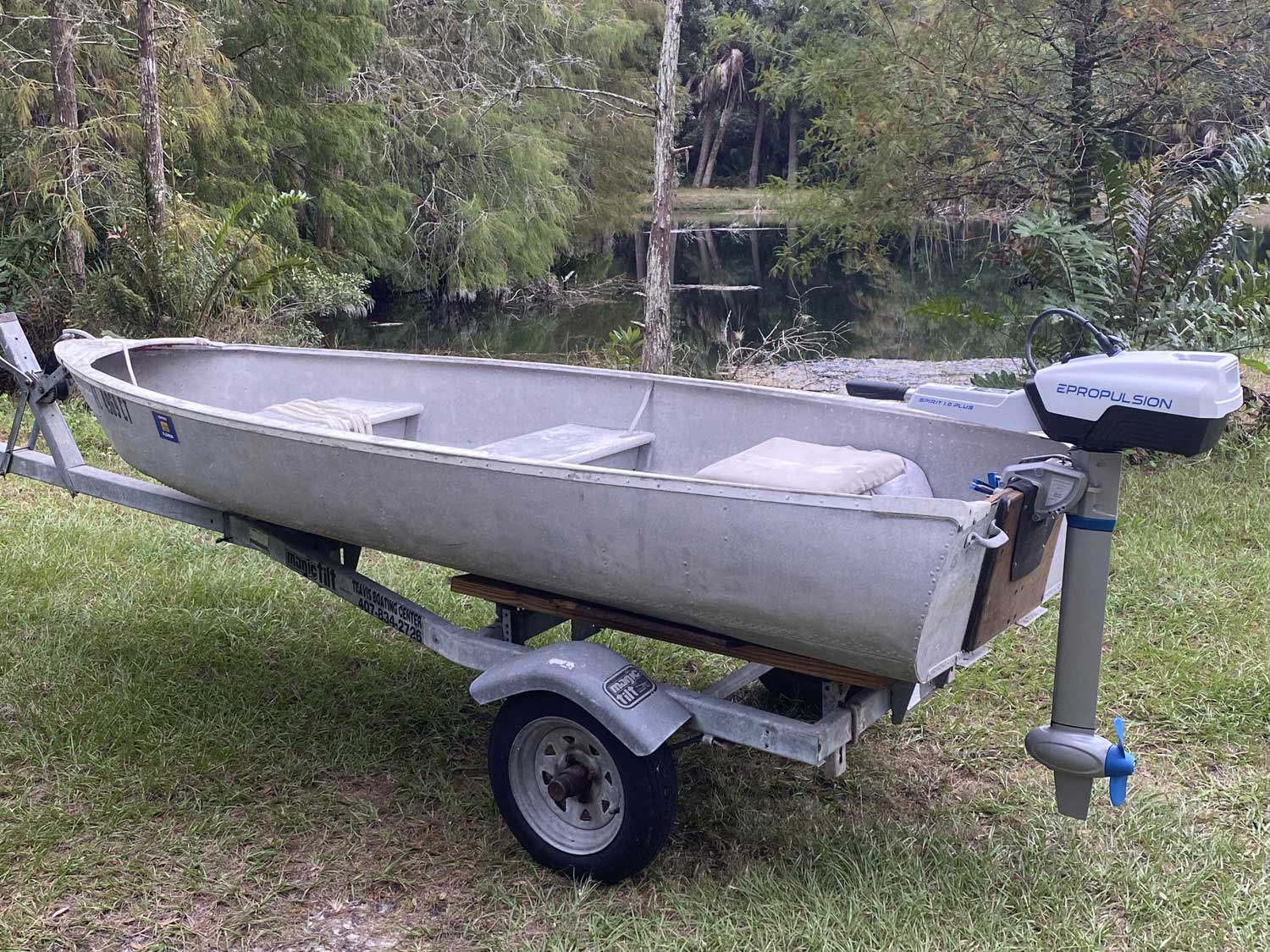

I decided to try out the ePropulsion Spirit on my little aluminum boat. My dad bought this boat new before I was born. I've operated it with a 3, a 3.5, a 5, an 8, a 9.9, a 10, and a 15 hp outboard over the years.

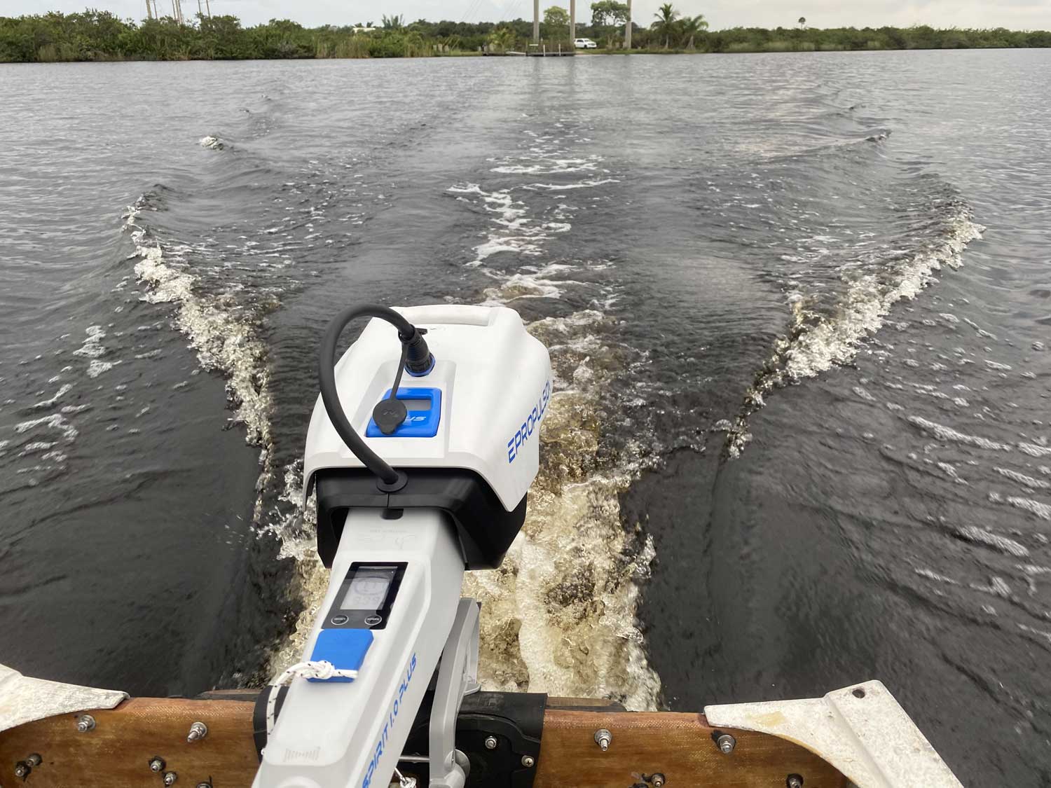

After I went back to the house to fetch the magnetic kill switch, it worked perfectly.
Went 5 knots at full power. That's not quite equivalent to a 3 hp gas engine, but very close. Should be plenty of power for the Picnic Cat.

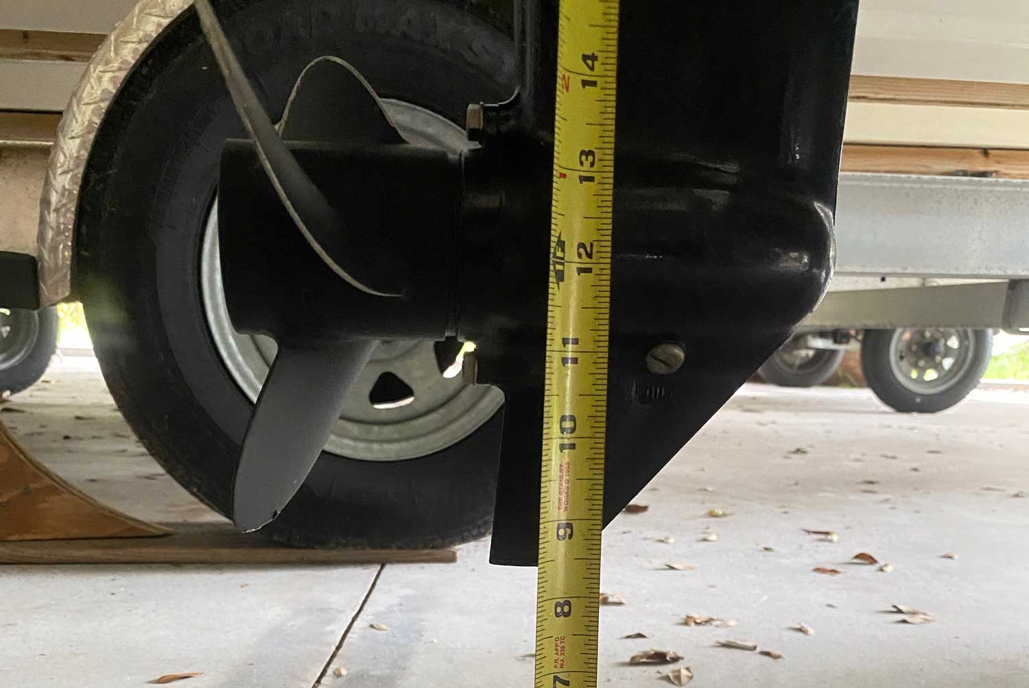

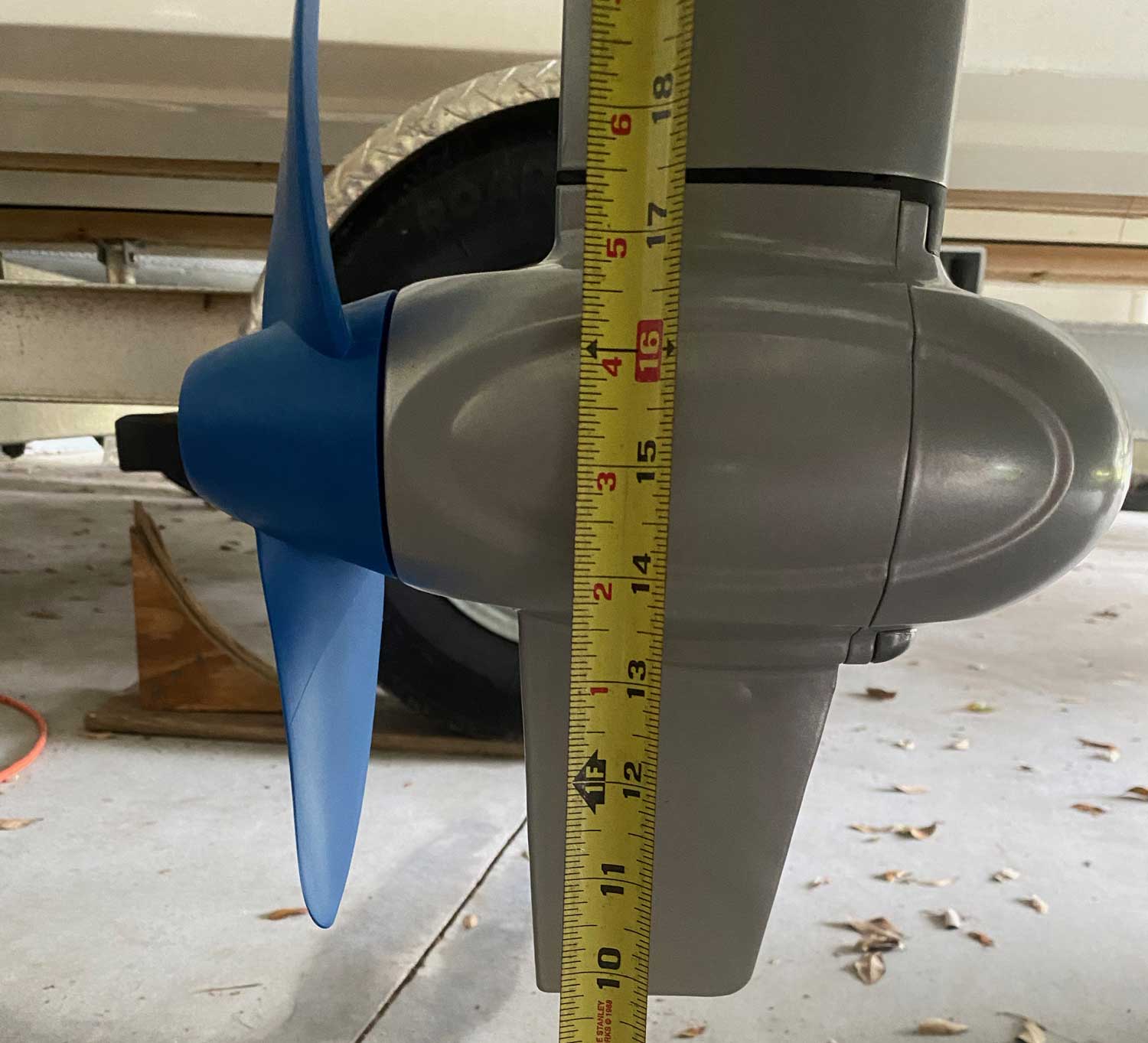

On the shaft length question, the salesman told me that XS (extra short) is what all other engines call S, or short. An ePropulsion S is equivalent to any other outboard's L.
Tape measure says...
Tohatsu 5 hp with 20 inch shaft. The shaft is about a foot off my concrete floor.
Didn't move the boat or the motor bracket for this pic:
So the prop shaft sits about 3 inches higher than the long shaft Tohatsu. No cavitation plate on this motor. It looks like it will be deep enough with the bracket all the way down.

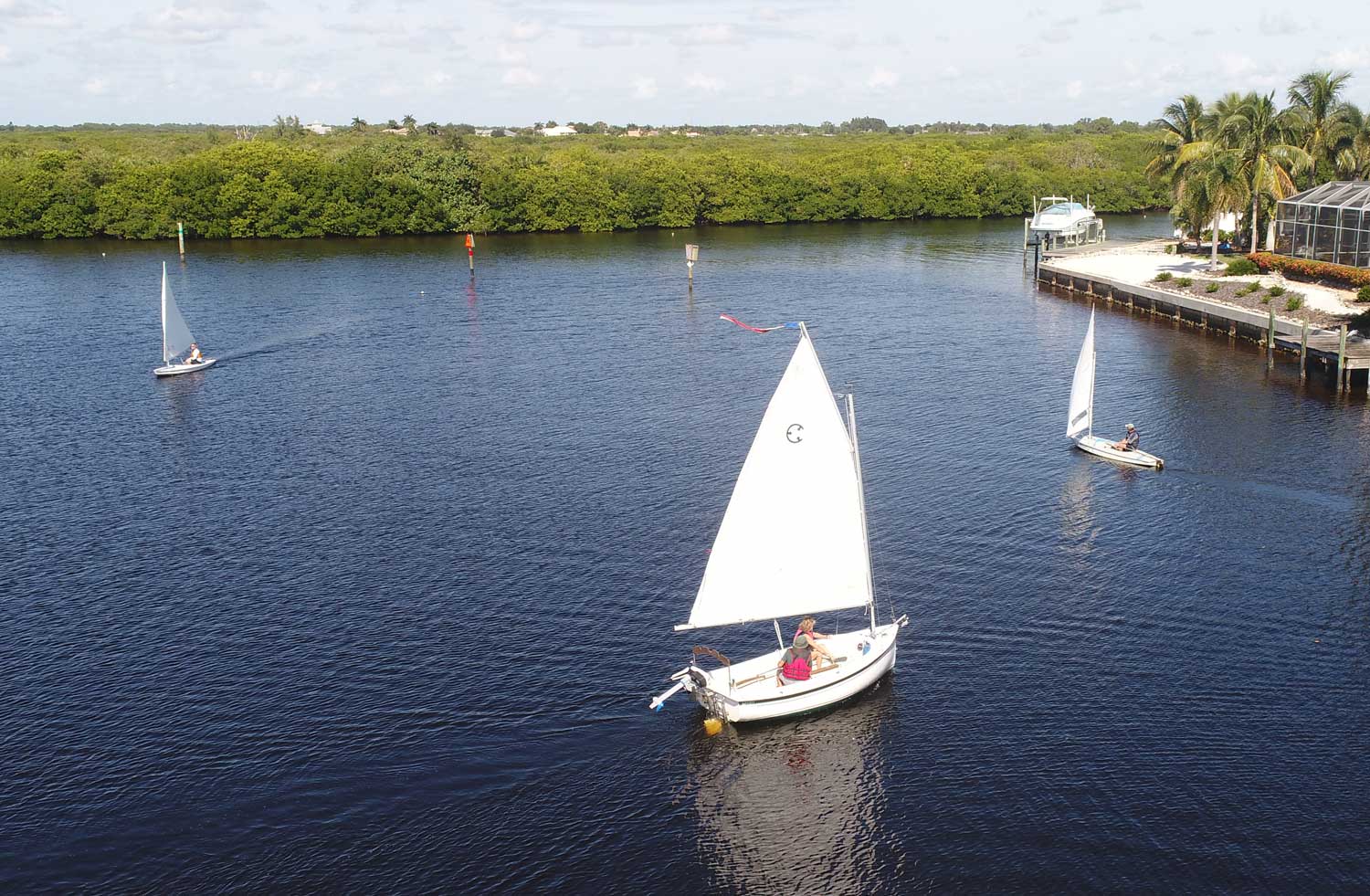

Finally got to try my new epropulsion on the toy catboat yesterday. It's great and my wife's reaction was that she wants electric motors on all our boats. So I guess I'm in the market for a 175 hp now. Can't imagine what that battery pack will cost.
Anyway, the first question was about cavitation. I know, it's ventilation, but I have always called it cavitation and won't stop. Moving from the boat ramp to the Sailing Center's floating dock, I got up some speed then went to full reverse. It did slurp a bit of air down from the surface, but only because I hit the throttle so hard. Easily controllable if I should have to panic-stop.
Next question was about power. More than enough. Makes the boat squat just like too much gas outboard power does. It could power a substantially bigger sailboat.
Next question was about chop. Yes, if a good sized boat comes planing by in shallow water, resulting in a very steep wake, the pitching briefly brings the prop close enough to suck air from the surface, even at fairly low power. If using one of these in a place where I'd have to power though lots of chop, I'd definitely want the long shaft one.
Next question was about motorsailing. It was a perfect day for this. Gusts up to about 10 occasionally but mostly 5-8. A Picnic Cat can sail in that, but very slowly. I used just a bit of power from the motor and it worked great! Keeping speed in the lulls, tighter tacking angles, regaining speed after that boat wake, all better. My wife was trolling a spoon and picked up a little ladyfish. At very low power, the boat has to be really quiet to be able to detect the faint hum of the motor.
I didn't recharge the battery pack after my short test on the aluminum boat. Ran it well over an hour, mostly at very low speed while trolling. As we were coming in, I experimented a bit with the digital readout that estimates time remaining at the current power setting. At the low trolling speed, it was saying over 8 hours. At higher power, like I'd use to move into some wind and chop, it was saying 2.5 hours. At full power, it was saying 50 minutes. No idea yet how accurate all of that is, but the practical answer is that it has plenty of power to get out, troll around for a while if the wind isn't strong enough to troll under sail, then get back in to the ramp. That's all I'll ever ask of it.
Some guys came to sail Sunfish yesterday and Dennis took one of their friends out in our boat for a little introduction to sailing. It's a great boat for that, has a bit of the feel of sailing but it's pretty well impossible to scare someone with a Picnic Cat. She loved it. I flew my drone.
