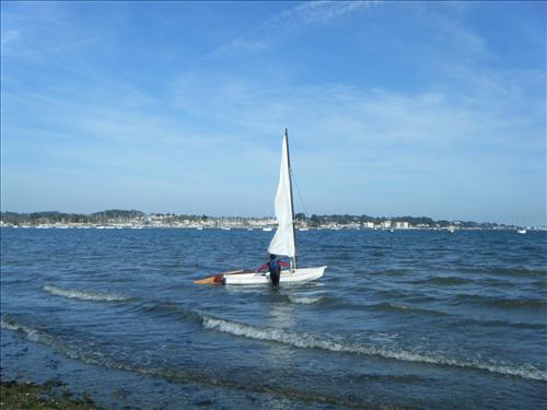

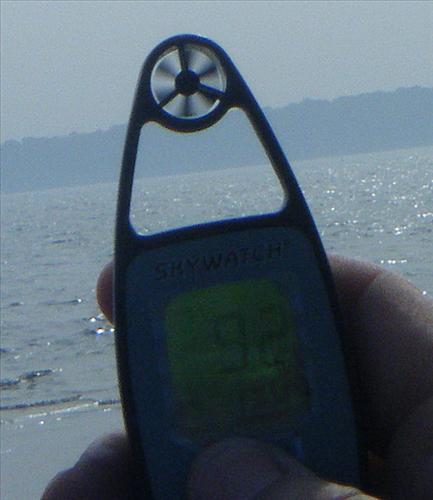

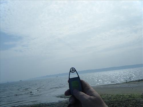

The wind was 9 mph.

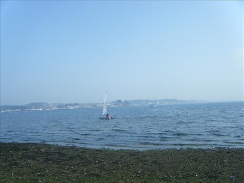

Celebrated a really good day with roast dinner and lego!
Took my boat home and went back ot play on the beach later...

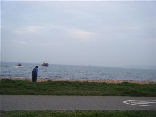

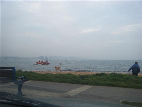

Seems some people didnt have such a good day.
One boat filled up with water, and another ran out of engine.
Luckily the lifeboat pulled them in.
