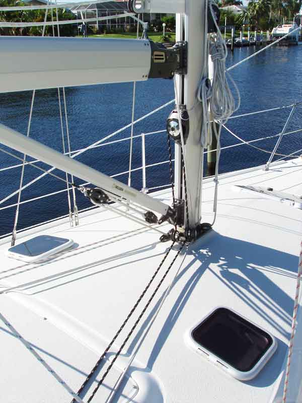

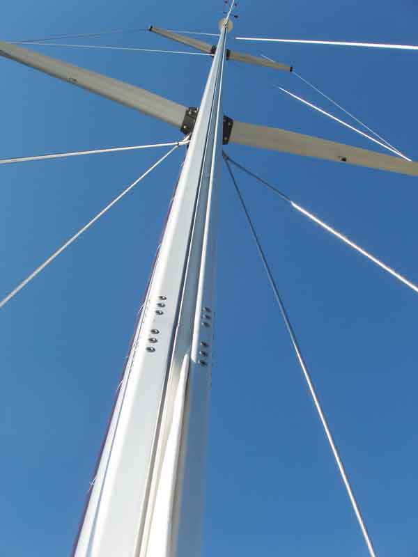

I'm an ex-racer, and for family sailing I love the in-mast. Mine has worked very nicely for years. I have partial vertical battens on a new (last year) main, they work very well.
We'll roll the main in or out several times a day as wind comes or goes, use it to fine tune main area for balance, it's fine. My mast is a bloody tree trunk, very stiff. I don't believe the system would work well with a bendy spar.
It takes me less time to get under way or put the boat to bed in the evening than it did with my 12' beetle cat when I was a kid. It's also much faster than rigging a windsurfer.

Cruisin Loser
Hate the mast howling sound at anchor.....
I've never had my mast howl at anchor. The boat lines up to the wind, the slot is aft. I know a lot of them howl in a slip in a crosswind, but I haven't personally experienced that, either.
I do have a strip to plug the slot on board, hoist it with a flag halyard, I've put it up once just to be sure it works.
But for a 30'-er I agree - a main on a 30' boat shouldn't be that big a deal to hoist, drop, reef and furl. As boats get bigger the value of convenience grows. Hoisting a main on a 40-50' boat is a big deal, and the hassle can easily make the difference between sailing and motoring, especially for a couple. If I had a conventional main on my boat, I'd have an electric halyard winch.
