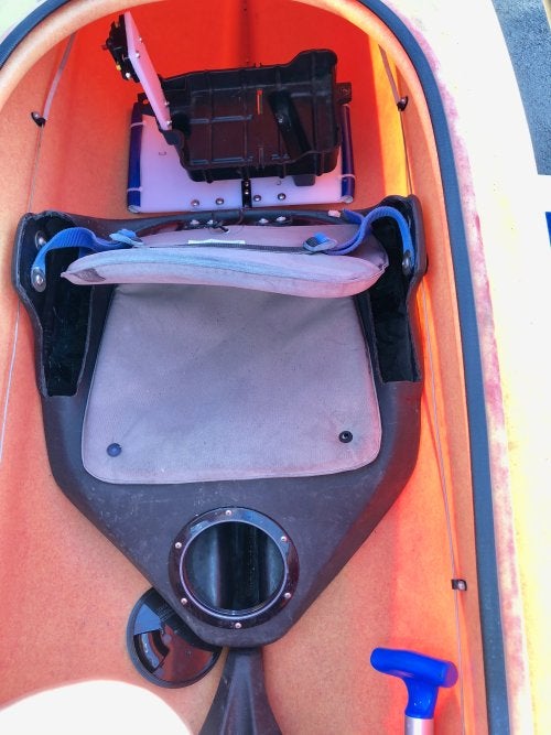

I'm only half serious.  I've heard the stories of them blowing up or catching fire, so I have to ask.  In my boat, a WindRider-16, the battery sits directly behind me, just under the rear deck.   :unsure:
Right now I use a single, 55 Amp/Hr AGM battery to run my Minn Kota Riptide-45 trolling motor, but it weighs a ton and, along with my 225# of meat and bone, pushes the stern down more than I'd like.  It also doesn't give me a lot of run time, given the max Amp draw on the motor is 42A.
The 100 Amp/Hr LifeP04, lithium iron phosphate battery would just about double my run time, and it only weighs 25lbs, but I'm a little worried about having it sit 6" behind my butt.
Should I be worried, or are the fire risks only when charging it?

The LiFePO4 batteries are the safest type of Lithium batteries as they will not overheat, and even if punctured they will not catch on fire. The cathode material in LiFePO4 batteries is not hazardous, and so poses no negative health hazards or environmental hazards.

You heard wrong.   They can overheat and even melt down but do not catch fire.   Blowing up, nope.   There are plenty of dangerous chemistries that can.

Cool, thanks for all the helpful replies!  I went ahead and ordered one, but I cheaped out and went with the $400 model on Amazon.
https://www.amazon.com/gp/product/B084DB36KW/ref=ppx_yo_dt_b_asin_title_o00_s00?ie=UTF8&psc=1
I know, I know, Chinese batteries are junk, but I just couldn't justify putting the $900+ Relion in a boat worth less than that.  83% of the 957 Amazon reviews were 5-Stars, and many of them were from people who used it for my intended purpose.
I'll be putting it in a box to make sure it doesn't get dunked in salt water, and I have a NOCO Genius-5 that's said to be sufficient to keep it charged.
Hopefully I'm good to go.  If not, I'll buy the Relion RB100 and chock it up to another one of my expensive lessons learned the hard way..
