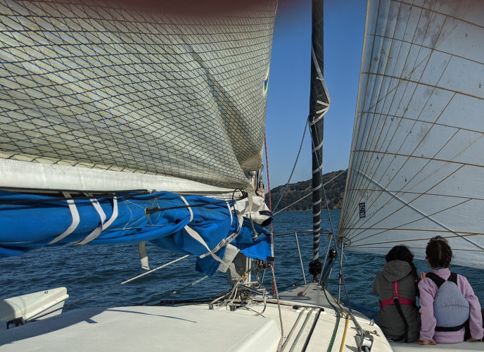

For my F-31, I have a UK Stackpack, which makes handling the main quite easy... in the worst case, it's possible to head roughly into the wind and blow the halyard, and the sail will end up safe, if not neat.  Normally one person is at the mast controlling the halyard with their foot, helping it flake a little more neatly, but we can easily drop the main in a few seconds.
While sailing, we sweep the the lazy jacks to the mast (they stay attached to the pack, and wrap the pack up, so there's no real windage.  (It's not "pretty" in the pic below, but it's possible to roll and clip it away neatly to the side of the boom.)

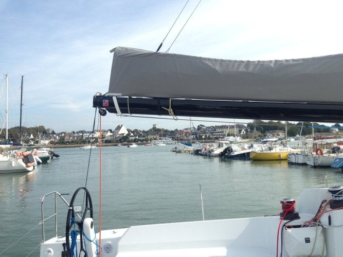

Works a charm on a bigger boat for sure. After years of dealing with a very hard to tame main with no lazy jacks and regular cover, I got a new main and UK Lazy Cradle this year. Cradle stows tight to the boom with nearly no added windage as can be seen in the pic. Dropping the main into the bag after sailing is a joy, and makes handling it a lot easier short handed.

That is a nice tidy system. I could never accept the bulky covers that store like the RedHerring pic a few posts above.

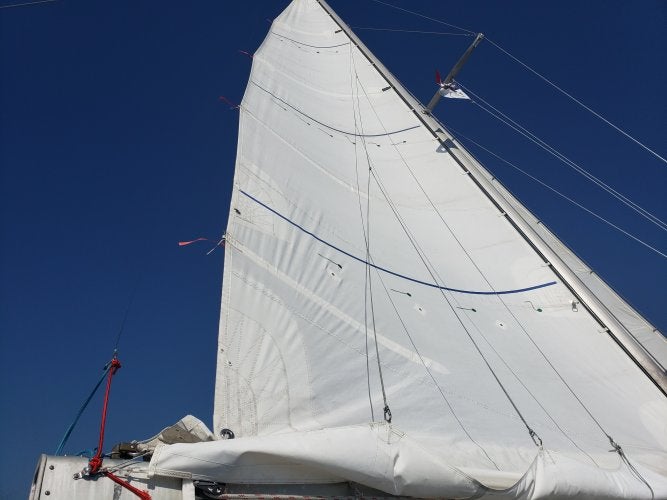

I made this instead of a stack pack after seeing the imocas.  I set the lazyjacks so that they are just loose enough when I'm fully sheeted on for upwind that they just lay against the sail.  Seems to work pretty well but my boat is much smaller.  First picture is with a reef in.
