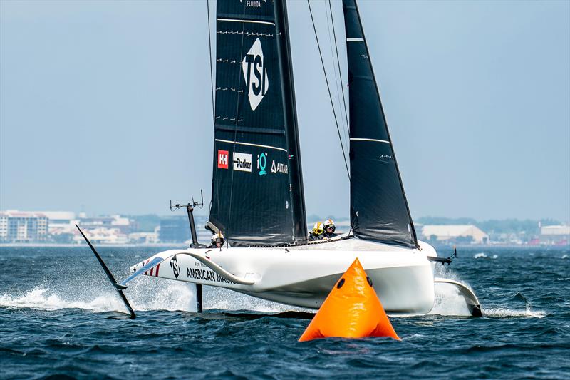

I know you're a fan boy and all but what is it about this frankenfoil that has you so hopeful.
Looking around at 'foils' generally, be they under a boat, sticking out the sides or front of a plane or in a turbine, they don't look like this unless it's demanded structurally*. There are good reasons for this, as mentioned earlier, what possible advantage are you guessing at and why would you imagine this group has found something everyone else who has considered it over the last couple of hundred years has missed?
*F1 'loves' to micromanage the airflow around their creations for sure - but that's a different kettle of fish
enigmatically2
4,744
2,456
Earth
If you mean me, the. I don't know. I get why the w has advantages for stability and low speed lift. But I am far from convinced those outweigh the disadvantages.
But Ineos have far more info than any of us. The AC is littered with history of one team seeing an advantage where others do not.
Some they are right, some do not. So of course I am hopeful. But confident I am not

Sure they have more info than you or me, but that's not the point is it?
Do they have more info than all other aero and hydro-dynamicists who have been considering these issues for so long - or is your contention that the requirements here are so specific that all that knowledge and experience is mute and that overly-complex, hard to build, hard to control thick draggy clown foils are actually a good thing now ;)

Hard to build? Hard to control? Thick?
not even you know how hard they are to build how hard to operate and anyone with a vaguely working pair of eyes can see that they’re as thin in section as anybody else’s.
the point is with the America’s Cup nobody gives a fuck who is second, least of all the people that were second. So you can either sit there and do a copy and paste of what the winners did last time or a subtle variation of the same thing and hope that your variation is a little bit better than what they’ve come up. or you can do something that is different that “throws the ball, as far as you can“ remember that phrase? and if it works (which it clearly does as it foils tacks and gybes, even the prior version did) the worst case is you don't win the cup, which puts you in the same group as four other teams who didnt win with there “superior kiwi clone” foils.
best case you’re ahead of everybody and win

If you visualize a choppy surface with the foil tip breaking the surface most of the time wont a W foil near horizontal have more chance of more of it being in the water? hence keeping the boat higher out of the waves? A bit of the hull in the water is more draggy than no hull in the water?
Could this be the thinking behind the W foil exploration?

possibly, the other thing I wonder about is that with the hinges on the bottom surface, whether they’re actually being used, partially to prevent ventilation propagating from the surface piercing section of the foil through to the rest of the wing,
For something that is “just a hinge” they start very very close to the leading edge and extend a long way back. Almost like a fence.
Fuck it, I don’t really know it’s just guesswork and I haven’t looked at their exact positioning versus what is sticking out of the water because we don’t have access to that.
Or because of the way the rules are drafted. I think @Mozzy Sails addressed this in his video on these foils.
Don't forget LR also had a foil like this early in the last cycle, it's the third time we've seen a gull style foil.
On its face it looks like the actuation challenges and compromises are what make this direction difficult. It's also an area that Ineos may feel they have an advantage.
Another possibility is that the geometric simplification you carry out (or don't) when taking CAD of foil like this into CFD creates tradeoffs between result accuracy or computational requirements - those sliding interfaces in the 'fence' features have tiny edges, as do all the edges of the flap segments. Maybe Ineos via the F1 connection feel they have the ability to simulate this better.
I suspect for the current gull wing foils on Ineos they're more interested in collecting verifiable validation data for this particular type of geometry and if so, they think they can make race foils in a much more streamlined fashion.
