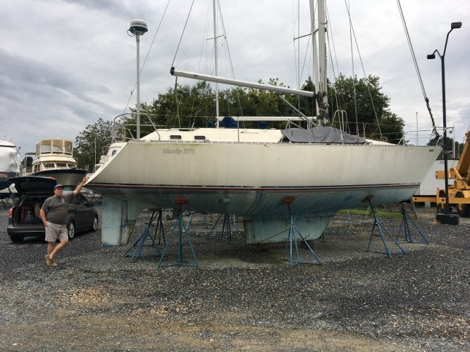

Well I took the plunge from small boat to big boats.   Target date for being ready to use is March 1.    going to be a wild ride with lots of uplifting moments and likely just as many "what was I thinking" types of moments.
First day on the boat I removed half a dozen 50 gallon garbage bags full of trash.  old paperbacks,  20 year old boating guides, dozens of plates, glasses, cookwares, crab pots, casts nets fishing pole ect.,  I replaced all running rigging with messenger lines cleaned up V berth area, clean out anchor well started cleaning the bilge, removed damage teak veneer from cockpit sole and seats, flushed all scuppers.   the in boom outhaul,  did not want to be removed, and now my messenger line and the line i was trying to replace are stuck in the boom.  so I'll likely have to drill out the rivets on the endcap of the boom to access.

friends have one like that, located in Greece, have been sailing with them quite a lot : bloody heavy & solid yacht that is, backing it needs skill and luck so if you feel like adding a bowthruster then go for it, the one real problem was/is the electrical wiring and the big instrument panel ... bit of a disaster zone, but mostly due to previous owners adding stuff, then taking it out and leaving tons of cabling, most of it unused but only way to know is to disconnect and see what happens, the original documentation shows how/where the wiring goes but in a very simple way and there don't seem to be real electrical conduits, it's squeezed behind panels etc... so if you are stripping the inside for some reason then you might as well redo the whole wiring. Another problem area as the owners are not that young anymore is size of the winches, that's one of the reasons they like me to come along, I can still handle them but it's tough, they have been considering electrical winches for the sheets but cost is quite high and not any type can be built in.

definitely has a purchase on it as I can see it through a hole in the end cap, but the hole isn't big enough for the block to come through.  with a 16' boom, getting it home in a hatch back that isn't much larger than a Prius wouldn't be my first choice.
washed all the reefing lines, halyards, main sheet, jib sheet, and dock lines.  all came out ok, except for the topping lift,  it got "frizzy" on me  so I'll salvage what can of the parts that were protected by the mast and use it elsewere and I'll have to start spending the $$$

Good sailing boat from my friend Bill Dixon. Built by Marine Projects (now Princess Yachts). Solid and simple construction, although one or two bizarre failures of rudder stock. Roomy and practical interior. Interior wood work quality pretty basic, but that means you can restore it. Cabin linings usually age OK. Plumbing, wiring etc decently done by the yard, but sometimes screwed around with by owners.

CMS,  this boat had a complete rudder delam while going down the ICW back in 90, at least that's the story i was told by the PO.
He had a yard in NC weld some skins onto the frame so he could continue his trip.  Moody sent him a new rudder/post under warranty and paid for the shop time, hauling fees.  at least according the pile of receipts he gave me and correspondence from moody
I have a few hanging wires from one of the removed ceiling panels near the nav station.  looks like autopilot/instrument stuff.
good friends with the owner so he'll be receptive to Q/A as it come up.
all of the ceiling panel vinyl is sagging and has mildew staining.  my plan is to remove all the interior headliner and wall vinyl.  I figure the wood ceiling panels can be painted and put back up sans covering.
Electrical panel was replaced in 92  by a yard due to a lighting strike.  so I'm hoping that the PO didn't muck with it up too much.  Genset, hvac, refer, all installed by professionals, according to the receipts.
next visit will be Wednesday.  tackle the outhaul and pull all the chain out of the chain locker  and clean up that area.  I might have a couple extra hands on board which is nice.

ah, yes, the chain ... one of my little tasks while on the Moody is that when they heave anchor I go to front cabin, there is a little door to the anchor well and the chain tends to pile up  to bottom of the windlass and block the whole thing, so a shove now and then to spread the chain around the well is needed. depends of course a bit on place of winch etc... but you might look into that later if it's a similar problem. Couple of years ago windlass stopped working, appeared that all electricity related to windlass was located in the -wet- chain well and was corroded all over, no idea if that was original or not so another detail to check. That Moody comes to its own in the typical Greece afternoon F5/6 blow

mechanical windlass.  so no electric to worry about yet.  and I understand about the possibility of the chain building up.  I just want to pull it out,  clean it, inspect, and mark, and clean up the area.  already though about repalcing the flimsy wooden door with a proper sealed hatch. and also thinking about relocating the drain so any water on the chain drains outside the boat and not into the bilge.

Scheel keel.  draft of 4'6"  which is nice for the shallow water of the chesapeake bay, until you run aground and the soft mud sucks you in.
rumor has it the the loss of a foot  of keel depth didn't hurt performance too much.  but that's like someone telling you that your blind date has a nice personality...
