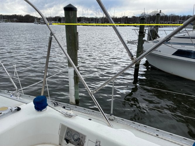

My 376 came with a bimini and dodger.  Going to build a new bimini.  The orginal bimini was only two bows and it had to be connected to the dodger to work. In other words, its not freestanding and it was too low, my head was rubbing.
So my plan was to res-use the existing two bows, and have a 3rd bow made with longer legs to use as my main bow.
I want to go strapless. The main bow(aft) will have a support that leads aft. Then I will have a folding strut that leads from the aft bow to the forward bow to hold it out in place. This is being done so I won't have to have any straps pulling the front bow forward. Which would result in some gymnastics to get in and out of the cockpit. the third pic, the yellow line indicates approximately where the folding strut will be located
the other reason for having/wanting the solid supports. is such that I can stow the Bimini in place against the aft bow and fold it up out of the way when not in use. the previous bimini if I did not want to use it. I would have to disconnect the main sheet lay the bimini down on the deck and then reconnect the main sheet.
Finally I got my bow bent and was able to purchase an extra 16' of straight tubes.
Saturday wasn't the best day. we had rain, we had snow flurries, gusting to 30knts. I finally wrapped up when my tubing cutter stopped working after the first cut...
the frame is assembled, the aft support bar is in place. the center lines were marked with sharpie and then covered in tape. we've got the bow supports screwed to the deck. so I still have 5 more tubes to cut. then I can start making patterns. Provided the wind is low this weekend.
