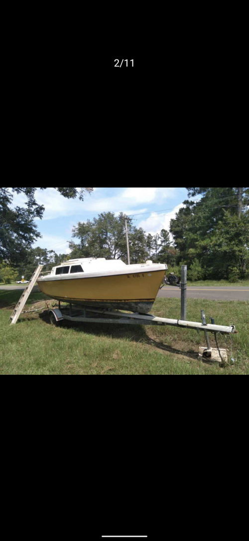

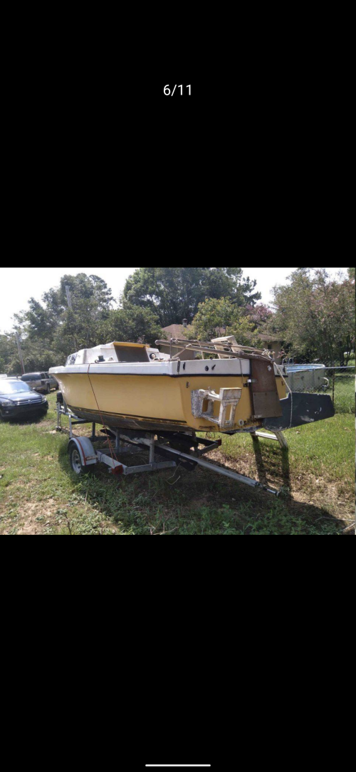

Rhodes 22 - anyone have one?
One has popped up near me for next to nothing. Solid project boat status I'm sure..
From what I've read, they are pretty solid little "cruisers"
I am looking for a boat big enough to do comfortable long weekend cruising in the Gulf of Mexico. But small enough to be easily maintained and trailerable.
Any thoughts from current or past owners?

I love mine for what it is.   Its a trailer launchable pocket cruiser for 1-2 people in semi protected water.    So far I've done some coastal cruising on three great lakes and Kentucky Lake.   Others have done much more.   (Sea of Cortez, Desolation Sound, Chesapeake Bay, etc).  One is for sale in the Med right now.    The owner's wife wouldn't let him sell it when they got a bigger live aboard, so they shipped it there for a couple summers.   The newer rigs are optimized as a convenient slip stored day sailor with in mast furling, which I like for after work sails when I'm tired and don't have much time.   It beats going home and turning the TV on, so I get a lot of sails per year.   The diamond board was an addition when the builder started renting to prospects on the shallow Albemarle sound.   Its very forgiving for accidental grounding, but won't generate lift as well as the older fins.   As a trailer sailor I regularly visit unfamiliar venues.   Lake Erie especially can be thin, depending on winter ice cap, so this is a positive for my style use.    Its not fast.   I get passed by longer waterlines easily but generally keep up with a Catalina 22 (though I have to reef before they do) and easily outsail a friend's Ensenada 20.  There's a math equation:   Do you want to get there fast, or do you enjoy the process?   It shines in a light breeze on calm water, gentle breeze on the lakes.      My personal wind envelope is 5-25, though I've been caught in much higher.
Phil Rhodes reportedly visited it at boat shows didn't disinherit it, so its fair to say he was paid for the design.   The builder did hire an industrial / aircraft firm to design the deck casting and the interior was done in house.    The flared hull shape was the builder's requirement, not necessarily Rhode's preference.  It provides good deck space, is surprisingly dry in chop and rigid (but heavy and the narrow beam at waterline hurts initial stability).   Trade offs.   The mast height is as original, but mast extrusion and centerboard have been changed over the years.
My pop top tent doesn't leak, nor does the pop top itself.   Some water will enter at the lower shroud chain plates.   The hull to deck joint is solid shoe box style, not prone to cracking from rough docking.   It will leak when you wash the side decks.   The boat in the photo looks older, it lacks the portlights on the forward house.   cabin top hatches are nice for ventilation, if present.   The new ones have 2, one over the head and one over the bunk.   The older boats did have a wood deck core, so usual rot concerns apply.   Some very old boats had wood stringers.   The interior does disassemble for repairs or upgrades, the sole and furniture aren't a hull liner.   There is a bolt on cap over the centerboard that is generally problem free unless damaged during launching.    Its ok to leave the diamondboard down when trailering, to center the boat on the drive on trailer, but make sure its up when you launch.   Integral flotation is adequate.

The cabin windows are unique.    The initial boats were built by contract builders, later Stan (builder) would customize to suit the buyer, but this may have been modified after the build,    I’d look carefully for quality concerns and also for any damage that forced the work.   Look also for stress at the mast step and supporting bulkhead area, either from the modification or collapse from rot in the bilge.
The rudder checks also may be custom built.  Factory versions angle forward and look less boxy.
