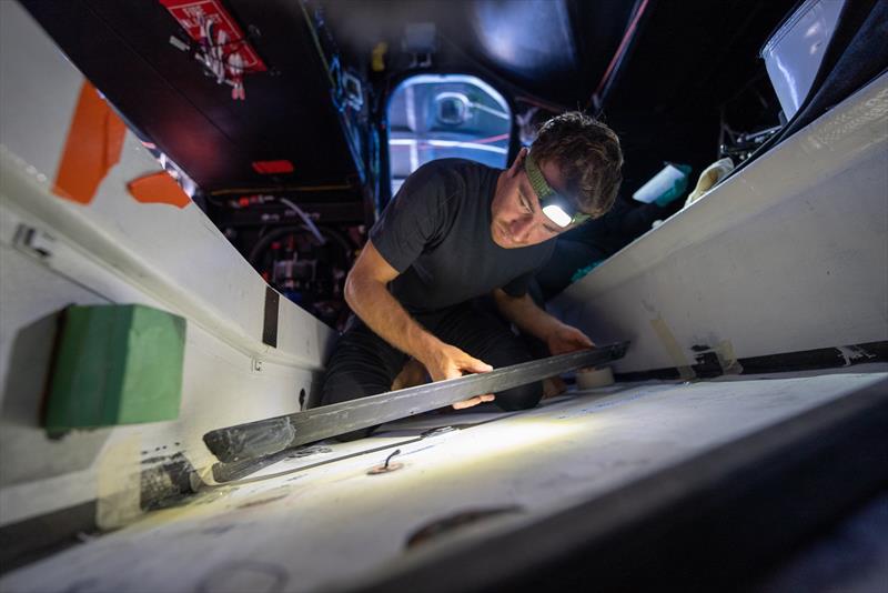

Thats not no, as it wasn't monolithic everywhere... only the bow, and thats the stern judging by the prop shaft?
Seems so.
I somehow misjudged the damage to be in bow, but that sure is a prop shaft.
And here is the damaged section inside, confirms the location:

I don't get it. Originally I thought Herrmann mentioned in an interview, they wouldn't use a "foam" core, but I wasn't so sure. Eliboat then stated a hull without a core was virtually impossible. The article I linked mentions foam twice, although explicitly only for strings and deck. Since Schütz produces honeycomp core, I assumed "foam" is precisely that and most probably it would also be used for the hull. So where does it say, there is no core??
Quote from Meomhy and this is what you replied to saying yes there was a core.
Malizia has a single-skin hull bottom full length. For reference, this is a thin single-skin carbon shell supported by many stringers, like an aluminium/steel boat. Many other boats have single-skin from stem to midships, or just aft of this. Topsides, deck, bulkheads etc will be a honeycomb sandwich panel. Also, the latest imoca rule does not allow honeycomb in the hull bottom.
The whole single-skin bottom concept has been around for a wee while now, with heaps of images and videos that show it. You can not have hull shell core failure if there is no core..
The stringers that then support the single skin however become critical..

I was mistaken. I didn’t see the article when I had commented on core vs no core. The method makes sense, but is vey unorthodox and prone to other issues I think. Time will tell! It would be interesting to know about the build process. My hunch is that it added a fair bit of time to the build.
