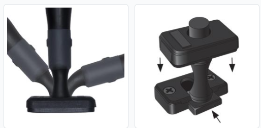

My 31ft Nantucket has tiller steering. A previous owner must have had an extension as there are holes in the tiller for one, but there was no extension when I bought it. I'm trying to decide what sort of extension/fitting to get. In my racing dinghy days (many years ago), I've use various extensions and my favourite was the bendy plastic universal joint type like the Ronstan below, but I'm not sure how suitable that type will be for a bigger boat. My boat has the rudder post right at the front of the rudder - while it is well balanced in most conditions, the helm is heavy in a following sea so I suspect something a little more heavy-duty would be needed. Can anyone offer suggestions - both what to avoid and what works well?
The type of extension in your picture is typically used with a dinghy or smaller keel boats.  Without knowing much about your specific boat you're probably going to want a more robust tiller extension.  Spinlock has probably the most common and better extensions with two different options for the tiller-extension joint.
The handle itself is available in either an "EA" version or "EJ" version and for the joint you can go with either the "diablo" which is similar to your picture but much bigger (like a windsurfer universal joint) or a full swivel joint.  Both joints work well, comes down to personal preference.  After using the diablo I switched back to the swivel joint.  Just my personal preference, many people prefer the diablo.  I like the swivel because if I need to take my hands off the extension for a few seconds it stays where I left it.
