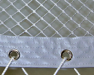

The nets are not solid at all.
They are obviously not open netting and definitely restrict wind flow compared to large diameter mesh:
if they are the same as was used by Dragonfly a while ago they are nets....much thicker than anything you have pictured. The openings are far smaller in each cell.
That said...even what you have pictured is a truck load of windage when set as a sail. gotta keep that lee bow above the tide.....just
What's the argument here? If the 1 3/4" mesh pictured "is a truck load of windage", then the Dragonfly "nets" with openings that "are far smaller in each cell" are far more so, right? Like this example, found here: http://www.multihullnets.com/product/productmesh.htm
Square Hole Mesh
This is a very strong woven mesh with 1/4" wide fibers and 1/4" holes. It is coated with a heavy vinyl coating in white only. The openness of this mesh is slightly less than the Coated Polyester Mesh but it is twice as strong. This mesh comes in a limited width, so any nets with the narrower dimension of more than six feet would have to be seamed. All seams are double folded and covered.
By the way, larger volume amas give plenty of warning when the boat is pushed too hard, provided the driver knows how to read them. Not releasing the mainsheet appears to be the primary cause here, the extra windage of the fine mesh netting was secondary.
P.S. Here is a page discussing "Openness Percentage" of netting (Webbing Nets, Mesh Nets and Open Nets):
http://www.multihullnets.com/tech/techopennes.htm
The 1/4" Square Hole Mesh net pictured above is rated at 32% openness, compared to 75% for 1-1/2" Ultra Pro Polyester Open Net, pictured below:
Just for completeness, their Dyneema 1" Open Net is rated at 755 lbs/in, Openness: 69% (Grommet Border) to (76% Rope Border) - compared to 235 lbs/in for their 'Ultra Pro".
