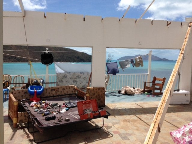

Post Irma both our families have evacuated and returned, my roof went, Steve's didn't but in general things have settled down and it's time to glue her back together.
