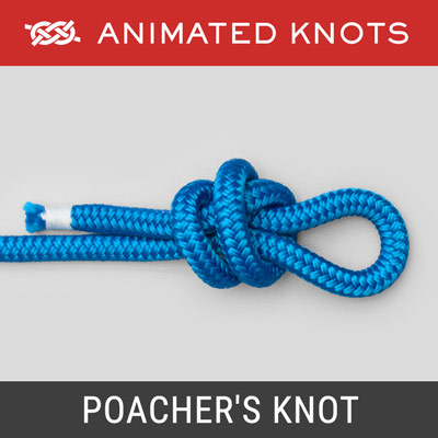

John MP above has the right idea. I tie in an eight knot in the end of the sheet and fold the sheet over on itself a couple inches behind the 8 knot, shove that through the grommet in the clew of the spinnaker and put the 8 kn through that loop and pull tight, it will not shake out. But still quite easy to undo when you want to. Figure out which way to push it through the sail so that the end of the pole goes right to the clew of the sail itself and the 8 knot ends up on the outside of the sail.
